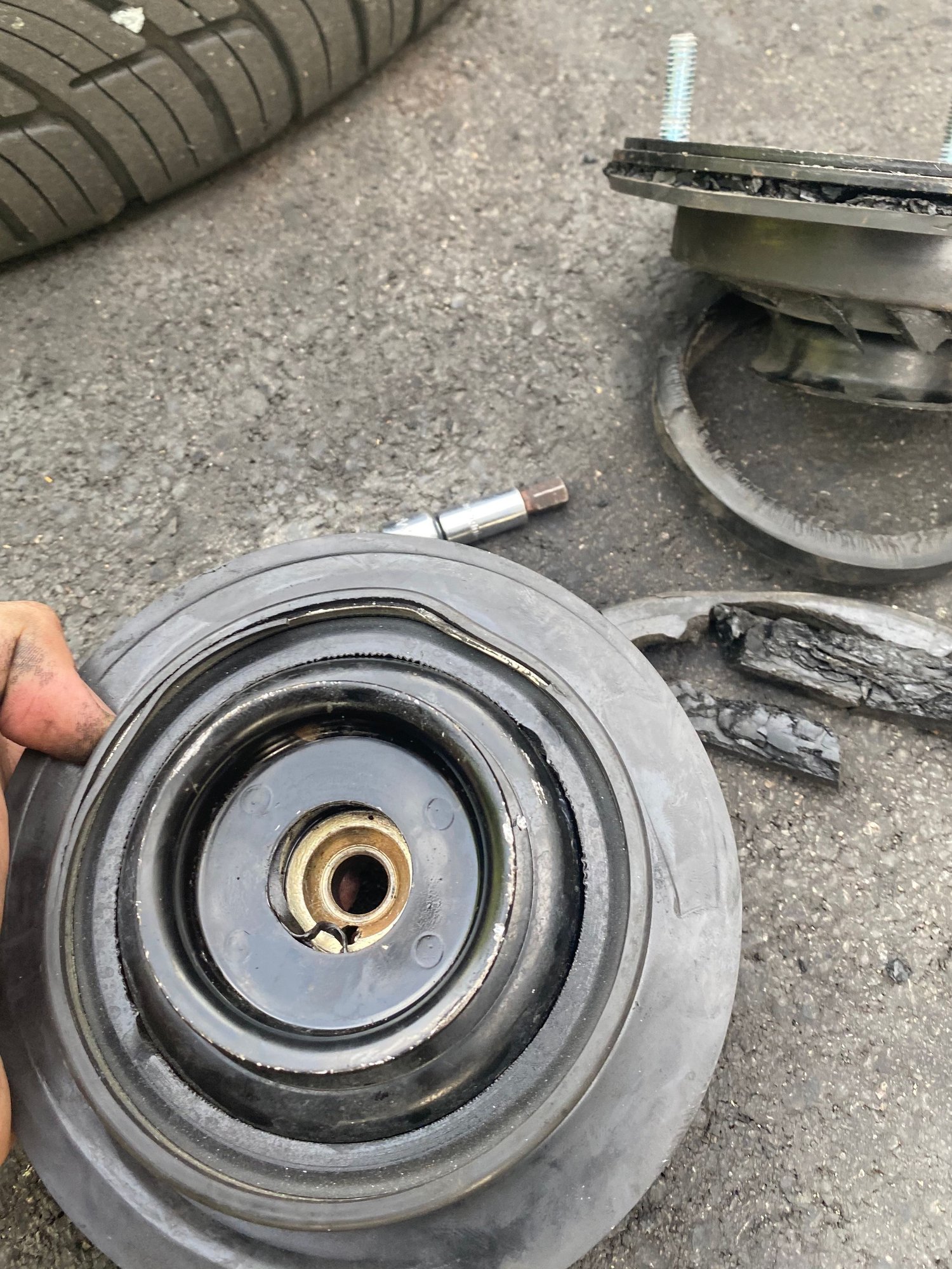

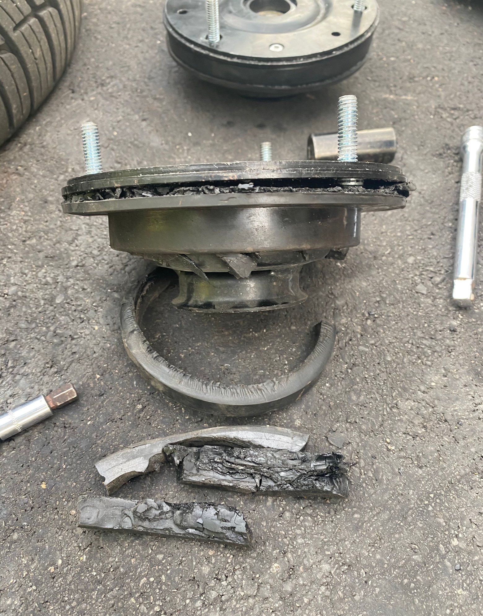

Originally Posted by WelshEnterprises
Welsh Enterprises sets a high standard of customer service and the products we bring to the market. Thank you for your feedback and for letting us know the product did not meet your expectations. We have taken the past week to examine the mounts on our 2003 XKR with the same mount installed in 2016. The XKR we inspected using these mounts did not reflect the issue outlined. We did not replace the springs and spacers upon installation. We found no fault reflecting this issue. Installation of springs and spacers may or may not contribute to this issue. Welsh has made contact with the customer to resolve this issue. Something like this will be handled on an individual basis, please do not hesitate to reach out to us at info@welshent.com or call us at 800-875-5247.
You should conduct testing with a more recent batch. Here's a picture of what happened to your mounts which I fitted to my car after only 7,344 miles, and a 1 year and 4 months. I think you will agree with me that this is not normal wear. I already bought another set from you in hopes that this was a fluke, but from reports in this thread, it seems unlikely to have been an isolated case. If this happens again in as little a time frame with the new set, I will have to bite the bullet and buy the OEM foam units.
