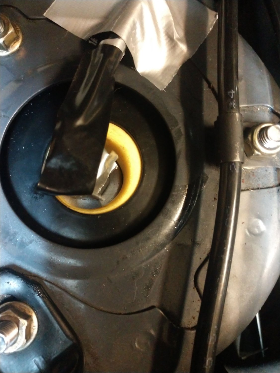

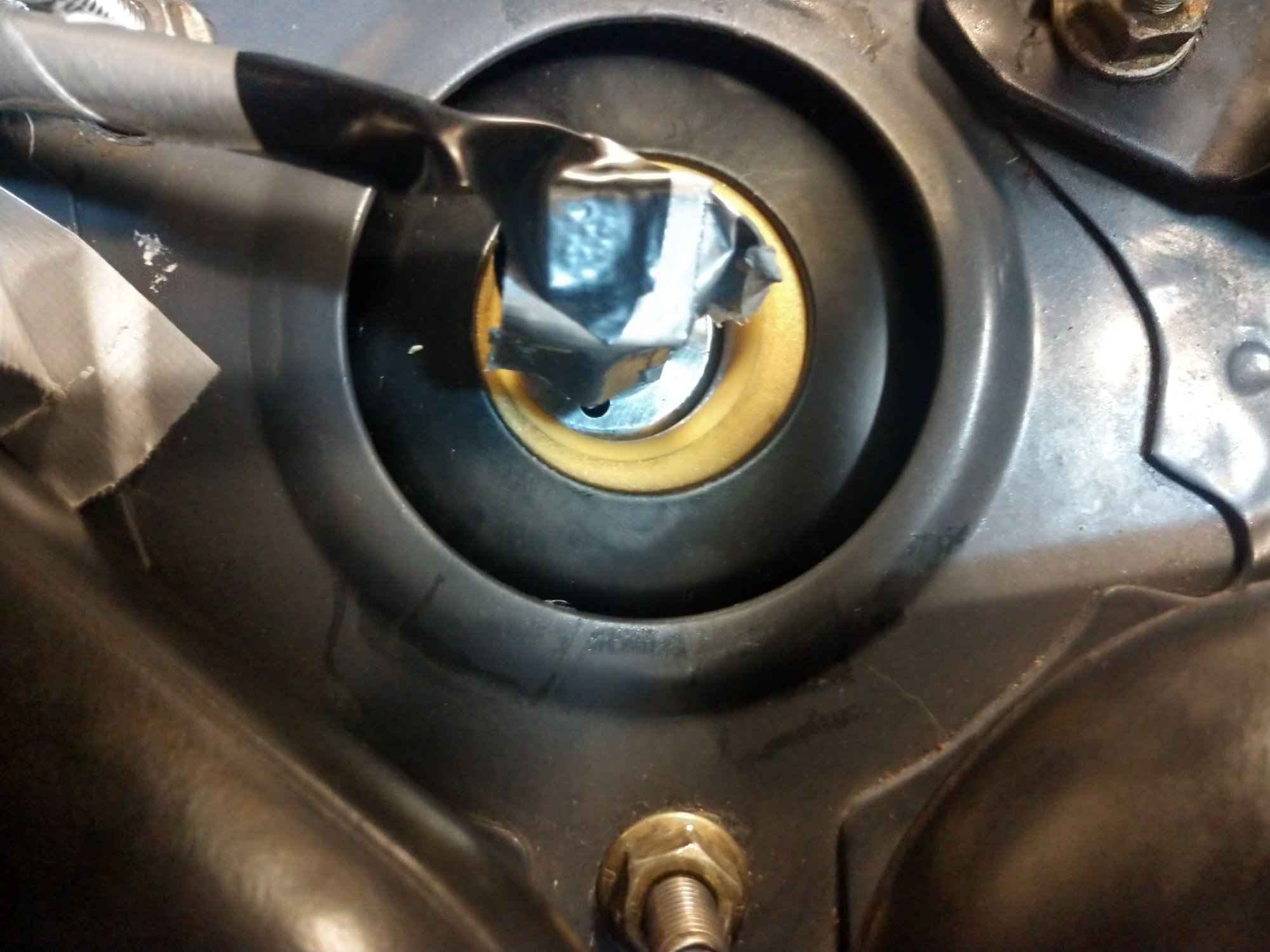

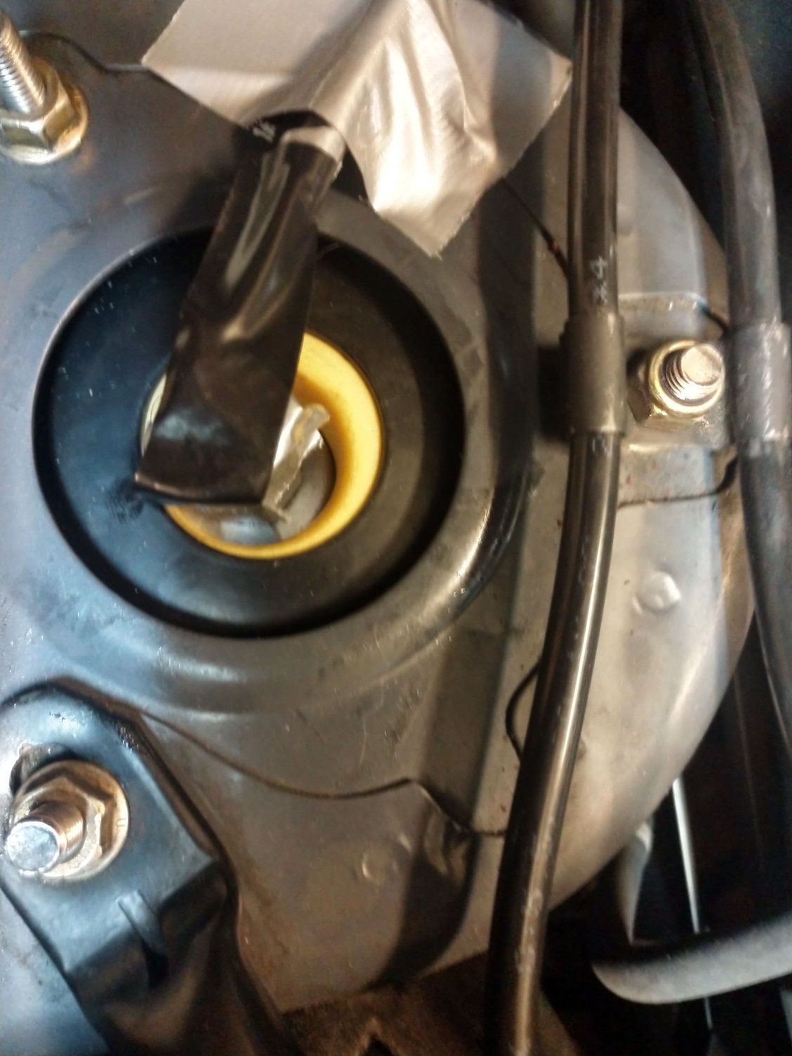

Default Pictures of my upper mounts bought at DCR after 1k miles
Hi,
Glad I found this thread as I was about to start one exactly about the same matter.
I've installed my shocks and upper mounts a few months ago. I don't drive the car much and the longest ride I've driven must be about 140 miles at once. The car got less than a thousand miles since those were installed - see pictures.
At first everything was perfectly aligned, right in the center. Now you will see in the pictures, the upper mounts foam has moved horizontally on both front side.
It looks like the strut is still at the center, but the yellow foam moved between the plates. The duct tape on the harness plugs is just to secure the connection in place and applies no strength whatsoever on the strut, it's just for the wire.
See for yourself and comment please...
Now my question is, what are the consequences or problems that can arise from that and does that say something isn't installed properly? I find it surprising that the top of the shock strut is right in the middle but the foam in the upper mounts plates moved so much. How could that happen?
Thanks friends. Stay safe!
Yellow foam not centered or aligned anymore although the angle of the picture makes it look not so bad it's at about 15-20% inside.
All considered the strut is still decently aligned in the middle.
That's a good angle to see the the poly has moved.

Any thoughts on my pictures in thread #71? Is that falling or is it supposed to move like that?
Thanks.
Thanks.
I'm no expert on these, but I think it's good the shock strut bolt is in the middle, but bad that the foam has shifted like this....
The OEM Jag ones that lasted me 85K were always centered on both the bold and the foam. Just my .02 but I'll let others chime in
Thanks. I wonder what would make the foam move like this. It's sandwiched between 2 plates and there's not much room to shift. It's like if the strut top would have moved forward and back, pushing the foam every time. All I can think of is the bushings at the base of the strut maybe?? But the struts are new, like 500 miles.
What would cause the shock strut to move sideways, in other words, other than up and down?
Any thoughts?
Thanks.
Being off-centre won't really impact camber, and the lower shock bushing will accommodate the slight misalignment, but they don't look happy. Almost as if the foam ring is too small in diameter.
Are they OEM or DCR's upgraded version?
