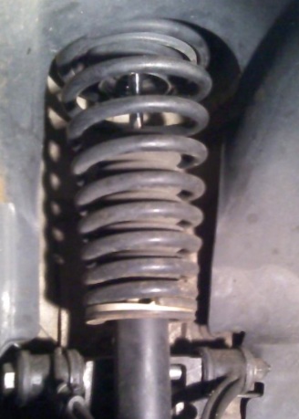

I have a 2000 XK8 coupe 4.0ltr, The car hides in the garage during the winter months, this year when driving the car I noticed it had developed a creaking noise from the front n/s, I suspected the shocker' once stripped the shocker was nearly seized even when held in a vice it couldn't be pushed in or out. I have ordered new shockers top suspension plate & steel spring supports.
Now here's where I need your help, the spring sits on a white nylon/plastic wedge spacer part number MJA2162BB which is no longer made or available, below this wedge sits two black nylon/plastic spacers which are easy to buy.
I will attach a picture note the white wedge (arrowed yellow). see how it holds the spring in place. My question to you guy's is where can I get a pair of these wedges or do we not fit it anymore maybe just the two black spacers help please.
cheers
Wullie

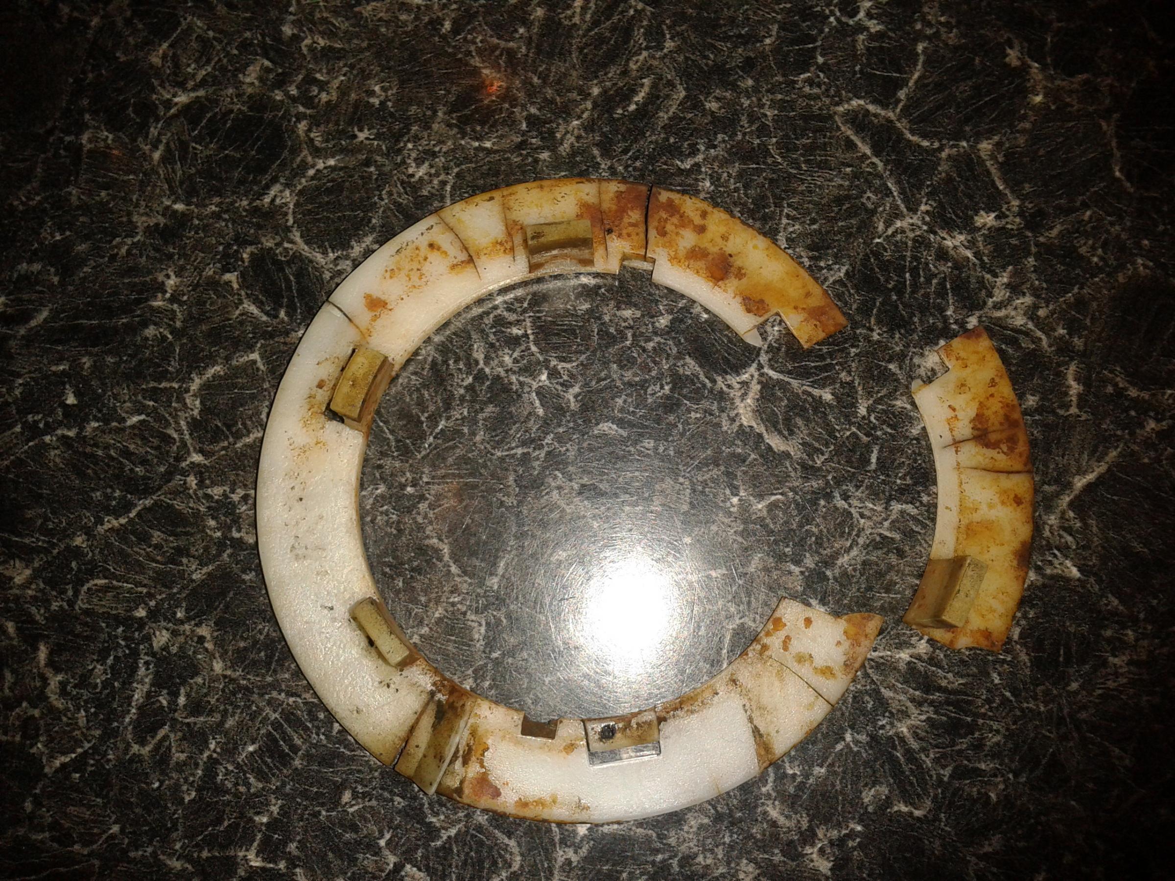

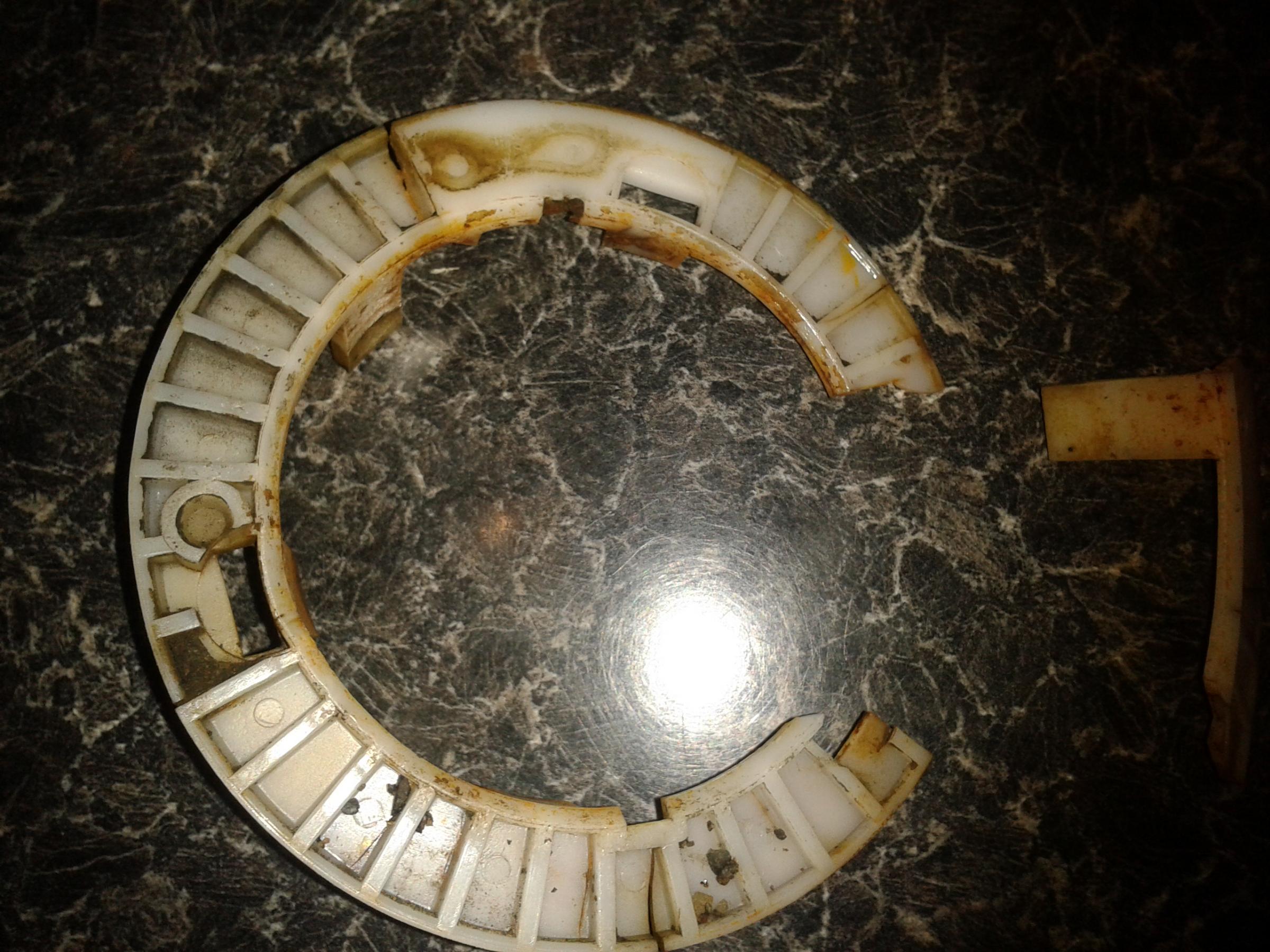

Pictures of wedge-spacer note the cracks with bit broken off,
Wullie.

My car was made July 2000 so your car will probably have the same cheap nastsy wedge, If your doing the job just be very carefull when removing spring from the shocker, my spring support seat was very rusted and swollen with rust, smashing water trap! making it all very tight, think this is what broke mine. I will buy a second hand unit assy £40 from Eurojag spares strip it down just for the wedge packer.
David Marks agreed that all we can do.
Incidentlly my spacers are black nylon/platic material not metal, anyway I have ordered 4 new ones from Jag parts dept', + new spring seats which are steel. I still have the other side to do but I will be extremely carefull. Will let you know how it all goes.

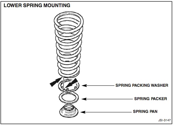

I went out and checked my suspension and yes it has the white spacer on the bottom of the coil spring. I found two pictures (see attached) showing the spacer and it is clearly wedge shaped and not flat like the part Jaguar sold me.
The JTIS illustration and assembly instructions mention making sure the coil spring is seated correctly and is up against the raised "stop" on the spacer.
So I guess that means my plans of leaving the old shock assemblies together is wishful thinking, as no one seems to have this part. In fact, it is not even listed in the catalogs of the usual suspects. I will have to hope my old ones are good enough to reuse.
Seems odd that out of the entire front suspension that this is the only part to go obsolete.

Worth a try, I have bought 4 off the plain black packers two on each side of my xk8. I have cleaned my old broken wedge packer bought special glue stuck it together, then I used a rubberised adhesive to stick the wedge spacer onto one of the black flat spacers, looks good and I think it will work fine. I will let you all know how it goes. I am still waiting on shockers coming mid May I have been told.
