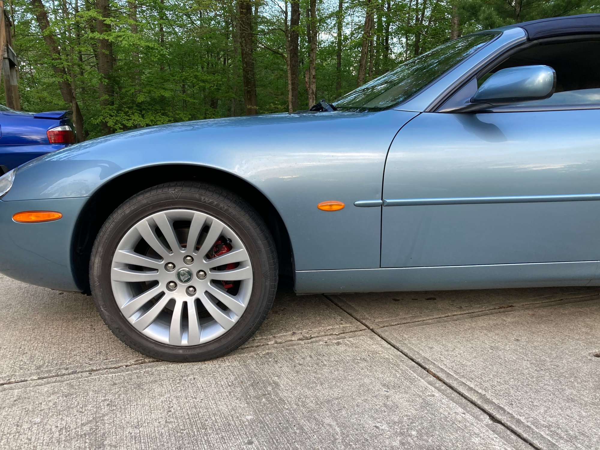

I used Lesjefors that I found on Amazon sold by an independent seller. Makes the front a little high but I'm hoping it'll settle some with some more miles. TM
