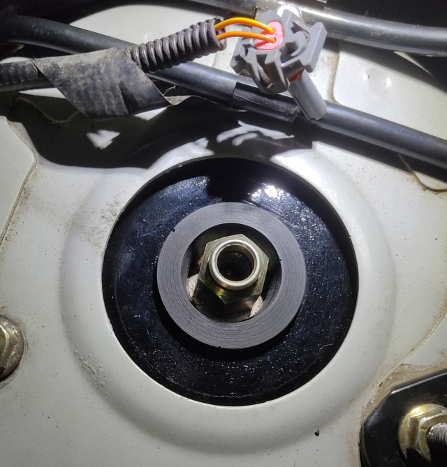

The only way to prevent the top shock mount bolt wandering is to use a non-OEM mount designed not to leave room for it to wander. If you simply replace with OEM mounts, then it's the definition of insanity expecting a different outcome.
These are Baxtor's mounts I fitted on mine in the winter, you can see how they fit to avoid movement - I'll report back in 5 years if they are still working as designed, but I think they have a much better chance than the OEM mounts.

Spring clocking will not cover for a bad top mount, but if you wish to do it, it won't hurt.
The "top shock mount bolt" is in fact the damper shaft. Very little keeping it centred in the mount as originally designed.

First thing to look at is your current OEM set up. By this I mean: Since you have an XKR look at your front springs and see if the Red Paint on the spring faces “outside” of the wheel well (as is the case in my XKR). Then look at the spring tail and see where it rests against the “white” spring seat. This should tell you how you need to “clock” the spring tail after installing new shock mounts ( either Wayne’s or Baxtor’s depending on where you live).
