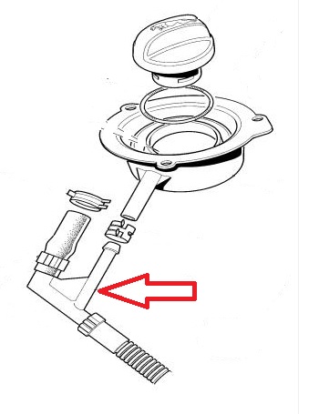

And it's very likely to be plugged with dirt at the outlet end.
Unfortunately you can't put a wire down from the filler bowl to clear it because there's a 90 degree bend in the drain tube assembly:
Push a wire or small drill bit into the outlet end to clear it.

And yes, that 90-degree bend is what was putting the kibosh on the seemingly-easy solution that wasn't...
