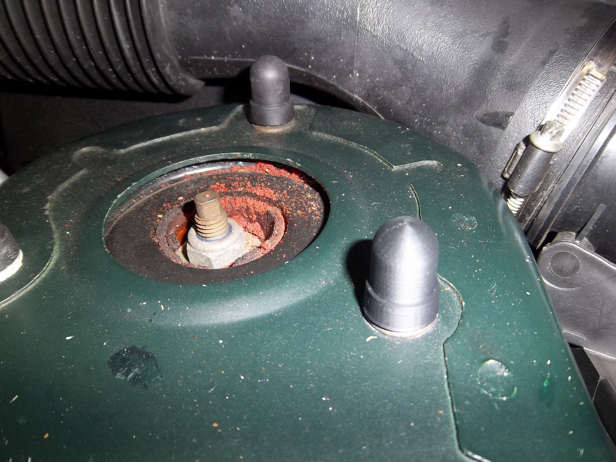

To anyone interested, we're also planning on making some upper strut attachment nut/bolt covers, if there is any interest. The prototype is at the front right, while an original is at the rear center. Slight differences, hard to get the design perfect using the 3D printer. I can't find these too easily. Please PM me if interested. Not sure about a price yet, but should be reasonable. I'm looking for two of the large center caps, as you can see! Previous owner just threw away any part on the car that wasn't welded on, evidently.
