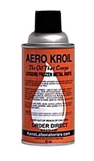

Neither do I!
I'll add a plea here for information on a European supplier of KANO Kroil:
Penetrating-Lubricating Oils
I keep reading wonderful reports of this US penetrating oil but have so far been unable to find a UK supplier.
It is available on Amazon but the shipping from the US is more than the cost of the product.

This is a case for a good nut buster. The best there is would be Aerokroil from Kano Labs. Nothing is as good as this stuff. Amazon has it but I never see it in retail stores. Next is PB Blaster. If you sprayed Aerokroil on this and let it sit for a few hours, it would come apart normally. I rebuild classic bikes and I could not do it without Kroil, it saves original parts like nothing else.

Aerokroil goes a long way, a can will last me for a year. Its worth the shipping cost. Just one saved rare bolt head or fitting will pay the shipping costs many times over. I also use it to coat the very costly stainless exhaust system to keep rust off of it. It will keep rust off of things unless they are submerged. This stuff is a polymer, not a solvent which means it has diffusion at the molecular level. It will get into joints that are tight.

I've seen tests on the internet where Liquid Wrench worked better than Kroil or PB Blaster.
I've been thinking ATF+Liquid Wrench or ATF+brake fluid.
The whole point of the acetone/liquid wrench/brake fluid is to help the ATF wick through
the rust.
Acetone evaporates too fast.
