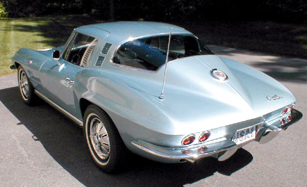

Oh come on guys---don't you remember having the antenna and looking cool crusing down A1A or 101?
or buzzing thru the Blue Ridge Parkway? Nice ride.
