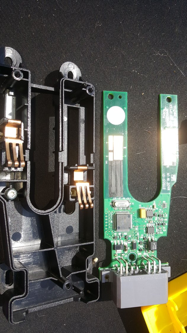

Sorry. This photo ain't so helpful...
Google Neutral Safety Switch - there are lots of images.

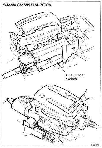

Dual Linear Switch... Sorry about that
