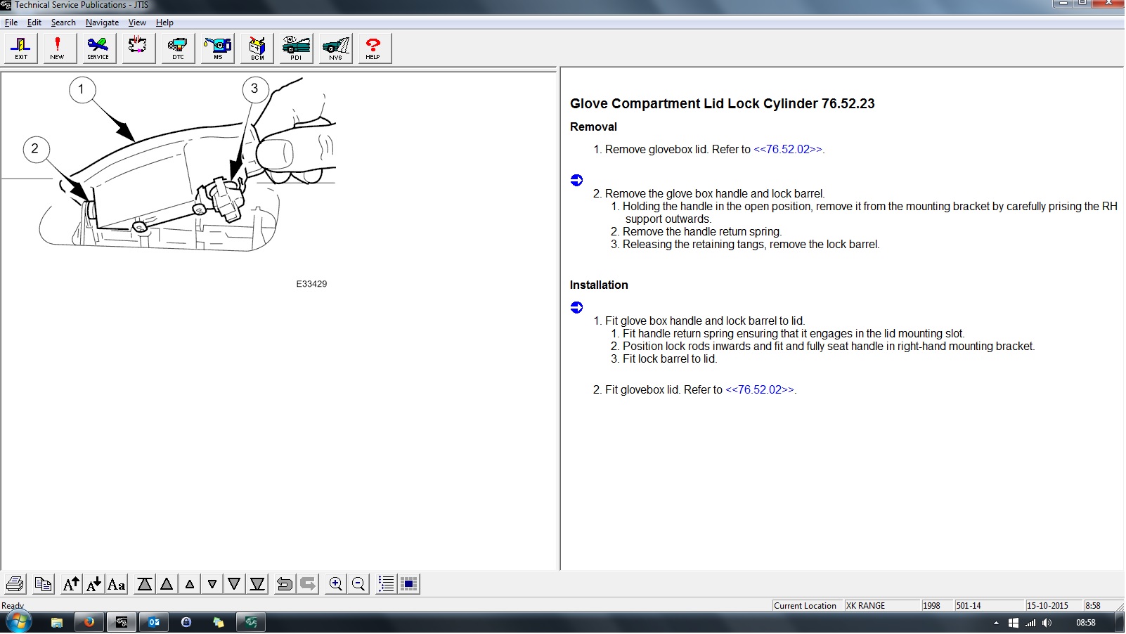

John,
I no longer have an XK8 but recall the operating rod mechanism as you describe.
Does the JTIS lock cylinder removal/refit procedure look as if it would give you access to the inner ends of the operating rods?
Glove Compartment one side doesn't latch - found root cause, now need to fix-glovebox-lock.jpg
