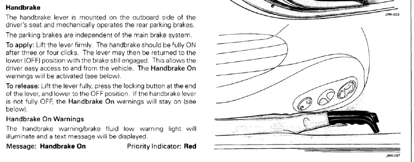

ill definatly point it out to release the brake if thats it,,,i do the brake tech as you mention,,and cant depress the button at all to release it,,the brake is on and dragging,,display lights etc,,if its only the adjuster at the y thats terrific,hopefully the release lube under the handle ?is easy to do ,,lube without taking out half the interior,,,which they already did,,either way the brake is on along with the dash display,,,thank you very much,,2nd time

I don't think you can actually depress the button until you have started to pull the brake lever sharply upwards.

It's in the drivers handbook....

Just for the record, It's not a true fly-off handbrake as were fitted to older sports cars for many years. They were applied by pulling the brake lever On and then pressing the button to lock it on. Release was achieved by just pulling the lever back and letting go when it would Fly Off unassisted.
