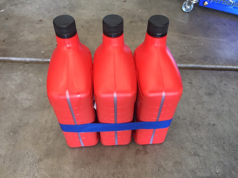

The second tip comes from the fluid pump that most of us will end up using. To be sure that I didn't accidentally knock over one of the fluid bottles while I was filling the system and also to allow me to move more quickly if I needed to, I taped 3 bottles of fluid together at a time. That way it would be much harder to tip the bottles over by accident.
