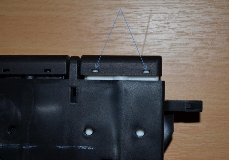

Originally Posted by scardini1
We can remove the buttons themselves? ............
The button covers have two slots at top and bottom which clip over lugs on the button itself. Here's the Switch Pack out of the vehicle.
From above (slots arrowed in red):
From below (slots arrowed in blue):
There's no need to remove the Switch Pack from the vehicle to pop the switch covers off. The pics just make it easier to see where the slots and lugs are.
Attached Thumbnails Hazards not turning off-hazard.jpg   Hazards not turning off-hazard-2.jpg
Old Nov 29, 2012 | 08:25 AM
scardini1's Avatar
Joined: Jun 2012
Posts: 1,245
Likes: 339
From: Gainesville, VA
Outstanding. Thanks GGG! Amazing forum.
So a dental pick, carefully used, should pop them free without damage.
Is my assumption about the probable build-up of gunk around/behind the buttons valid?
