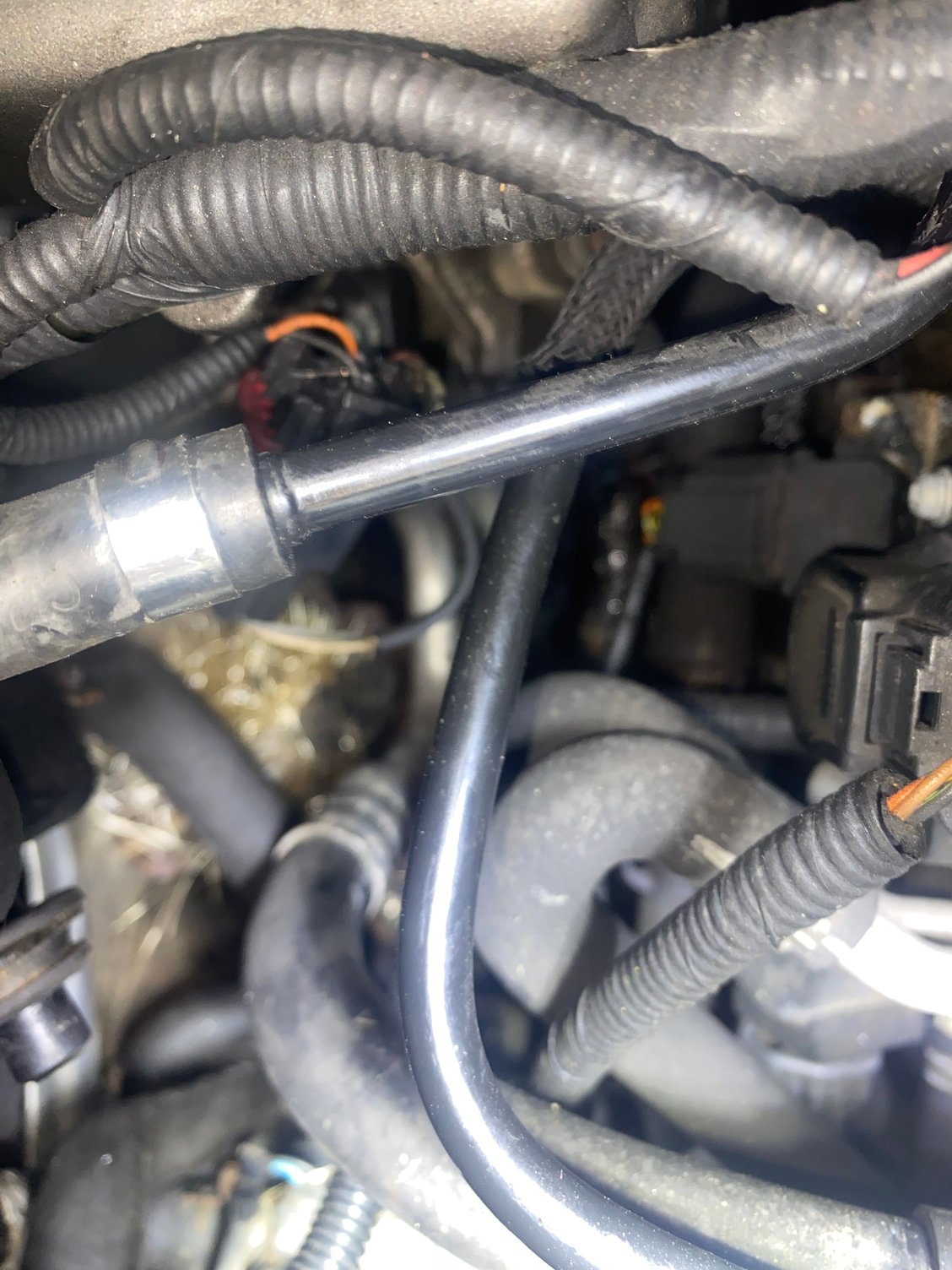

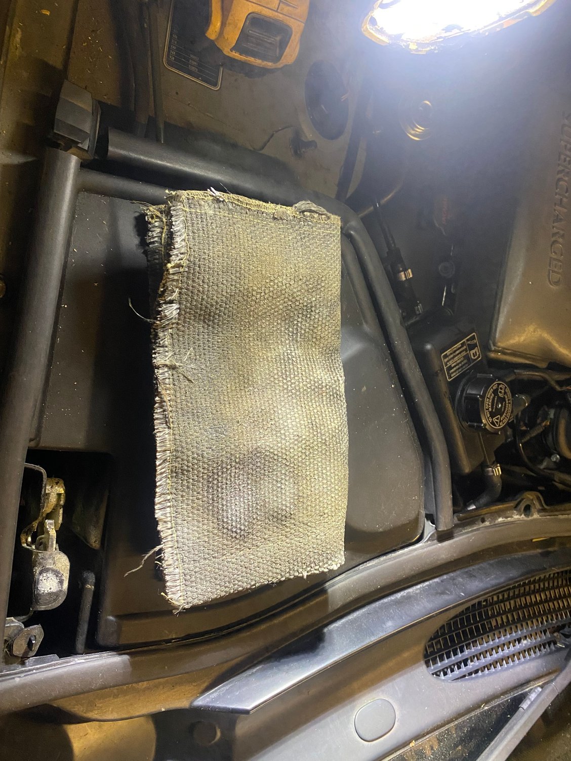

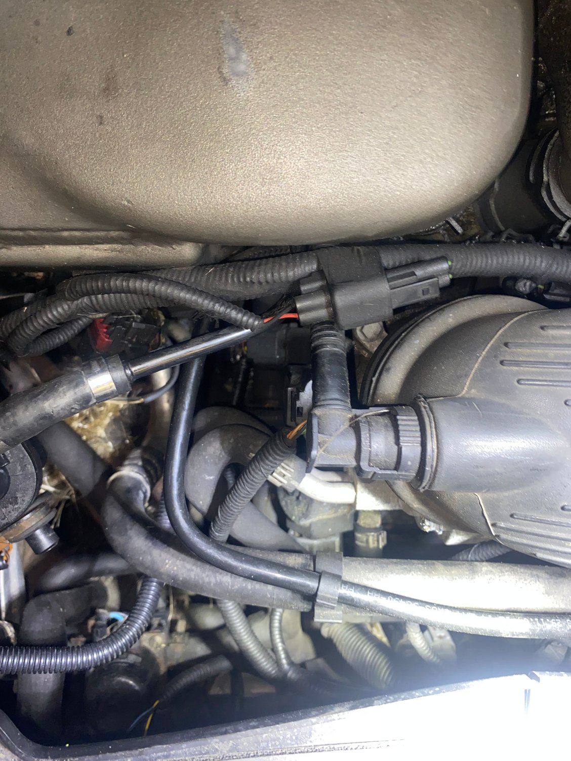

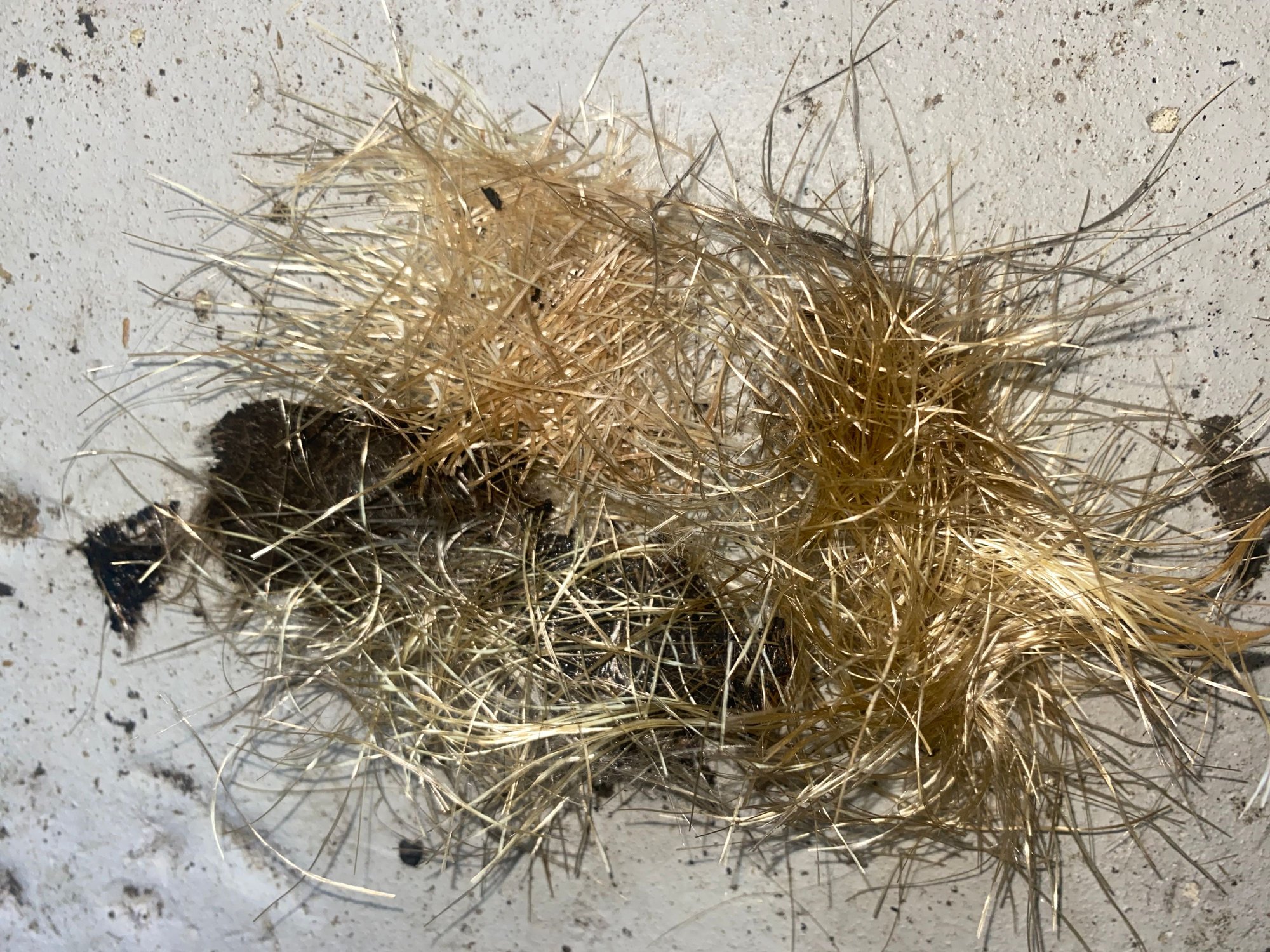

I noticed the above which appeared to have been situated between the exhaust manifold and closely situated rubber tubing on my 2005 XKR X100, see pics. There was nothing left once I had fished out the fibreglass straw, so, imagining it served a purpose, I have improvised by stuffing plumbers soldering fire protection matting in the same vicinity. Any thoughts or guidance would be appreciated.

Maybe a good quality fire blanket will do.. you know one of thoose you can buy to your home and cut pieces from it to fit... they are not expensive...

Yes, less cumbersome than plumbers heat shield.
Does anyone know the exact purpose and location.
Looks to me at though the rubber hose immediately above upper manifold branch is most at risk. Maybe wrap around this rather than the manifold itself?

On a non SC XK there is supposed to sit a cover/heat shield on top of the water heater valve, a blanket/cover thing on the metal tube to the EGR valve and a wrapped blanket on the plastic tube above that.. i believe water hoses are quite ok since they are kept cool with the water.. but for sure, over time...
