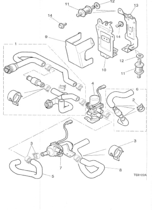

The following may be helpful.
As you can see, there's a control valve (4), a pump (7), and what is colloquially known as "the octopus hose" (1) for obvious reasons.
If your problem is a lack of heat in the car, the usual culprit is the pump. It runs pretty much all the time, and has fairly small brushes which eventually wear out. An exchange reconditioned pump is around £75.00 or so from various sources. The valve doesn't often give trouble - it's a simple solenoid and is pretty reliable.
IF it is the valve or the pump, it's worth getting the hoses replaced at the same time as they do age and deteriorate. It will add a bit to the bill (the hoses will be around £150.00) but it's not easy to get in there and so worth doing at the same time.
Also - quite possible that the hoses will be damaged trying to remove and replace the pump and/or valve.
