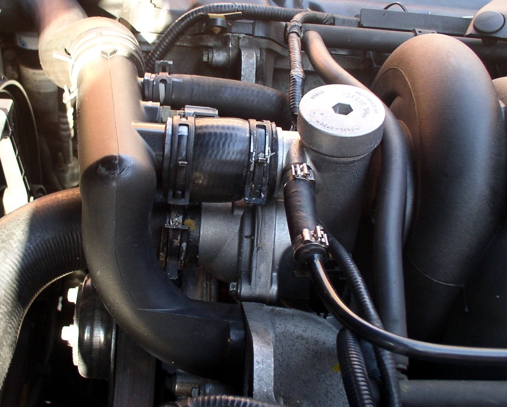

Originally Posted by taylor6632
ALSO, should the tiny length of hose linking thermostat hosing to the plastic water splitter be that bulging? You can see what i mean in the bottom picture.
Definitely NOT. Here's my 2001 XK8:
OLD BY-PASS HOSE
NEW BY-PASS HOSE
A new hose is a very tight fit and doesn't bulge at all with the engine up to temperature.
