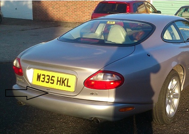

The boot latch assembly is all in a box section which forms the cill of the rear hatch (or bootlid). The XJ has it inside the lid and is different.
The release is actuated by a cable pulling on a lever placed mid way along the opening and inside the box. Look carefully at the lid closure and you'll see a gap under the bottom edge ------------------>
Drill a 4mm hole through as shown in the diagram below - that will allow you to slide a 3mm dia screwdriver in and actuate the lever - popping the lid. Close the hole with a blind grommet afterwards. ----------->

Drilling works great. I have a 2003 XKR and the hole worked perfect. I have a black car, so you can't even notice the hole and I have not even installed the grommet yet.
