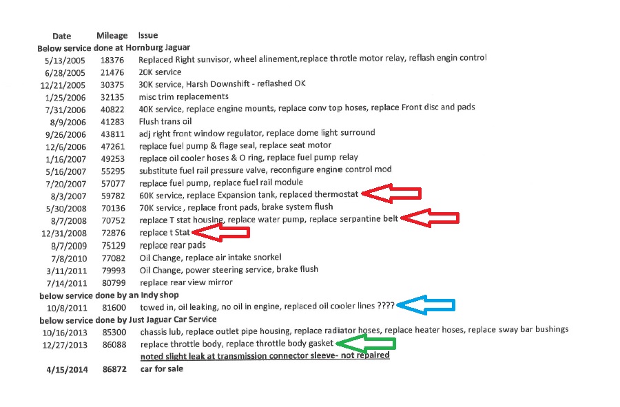

Aloha, Please take a look at the attached file. I found this 2003 XK8 and am very interested in buying. However I'm in Hawaii and the car is in CA. The seller faxed me the service records which I summarized and attached. This looks like a well maintained 2 owner car. I think at least one service record is missing as theres no record of the 50K service, also the last service has a troubling note about a leak at the transmission connector sleeve. Any thoughts on this. There were other service items I did not detail as they were minor trim replacements, wiper blades, etc.

The service on 10/8/2011 worries me. I've never worked on a transmission in this year, but if the leak was easy to fix they would have done it.

It looks good .......... but most Jaguars do.
Some items in the Service History would give me cause for concern:
The 4.2 litre engines aren't noted for cooling system issues like the earlier 4.0 and that is a lot of attention (see red arrows). My worry there is that it could have been overheated which is definitely not good news on a Jaguar V8.
Others have commented on the oil leak (see blue arrow). It has done over 5K miles since then so the reason is possibly the driver hit the oil cooler on a kerb etc. Running with no oil would have caused serious issues long ago.
The transmission leak is a regular issue. At least it's been noted.
Again the throttle body was a serious issue on 4.0 litre engines but a much rarer issue on 4.2 litre (see green arrow). Could be just bad luck.
Overall, the vehicle has been regularly serviced and had additional attention so has clearly had money spent on it. Given the distance involved, I would seriously consider paying for a CA Jaguar specialist to inspect the vehicle.

The cooling issue is a concern for over heating. The issue started at about 60K and apears to have been a concern for around 14 months and 12K miles but no issues for the last 14K miles. Curious???
The oil cooler lines may be as you suggested, again curious that they were replaced twice and this seems to be when the PO stopped taking it to the dealer for service.
The Tranny leak is a concern, could be minor or major, if it's not the tranny cooler lines as blueXK8ragtop suggests what else could it be and how much of a hassle to repair?
The service history seems to suggest that from May 05 to Dec 08 the car was well looked after but then either all issues were sorted out or the owner's attension fell off. The use of the car fell off as well from May 05 to Dec 08 they racked up 54500 miles, avg. 15570 mile a year. from Dec 08 to current only 14K, avg. 3K miles a year. This could also account for less service issues.
