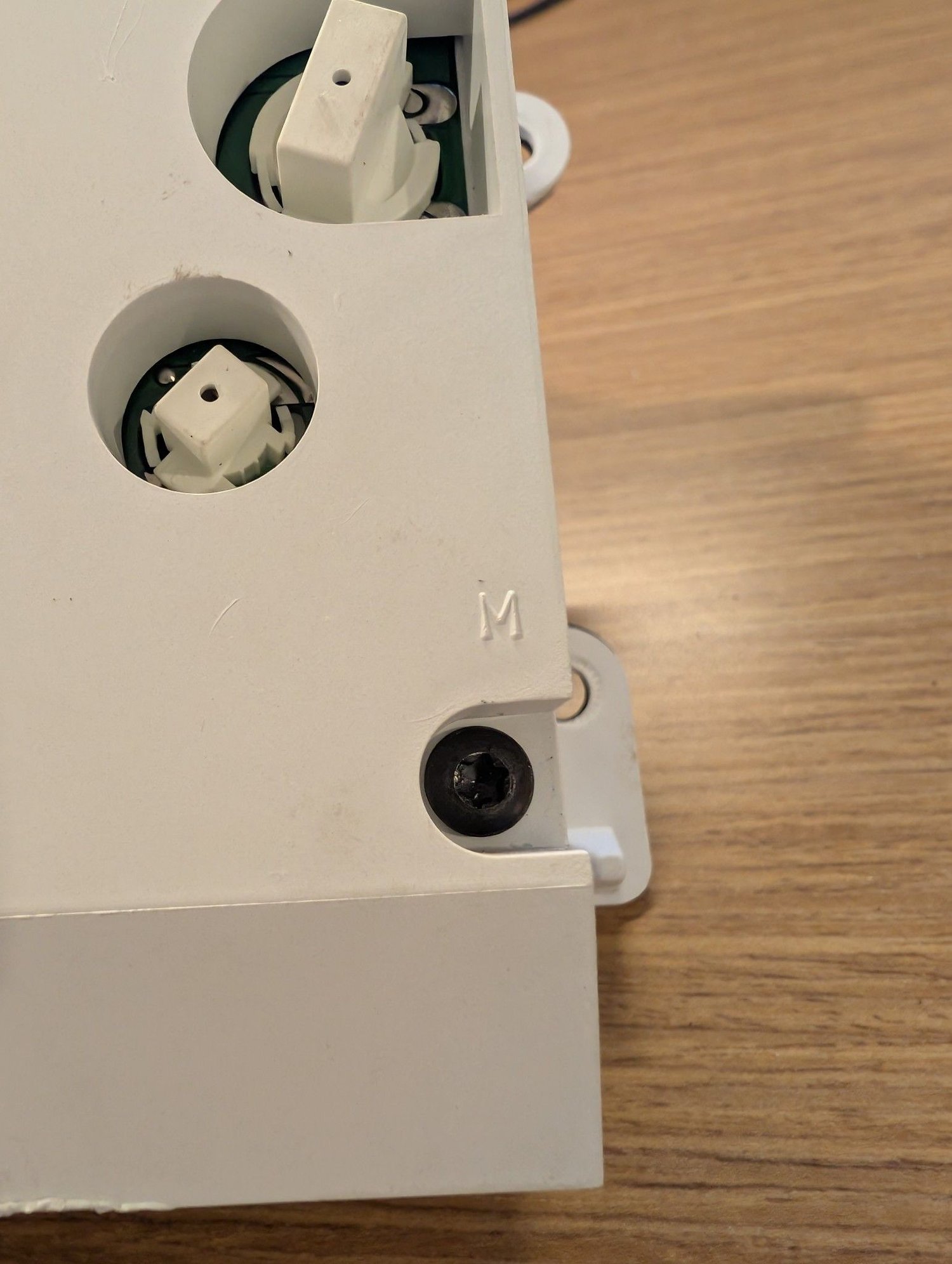

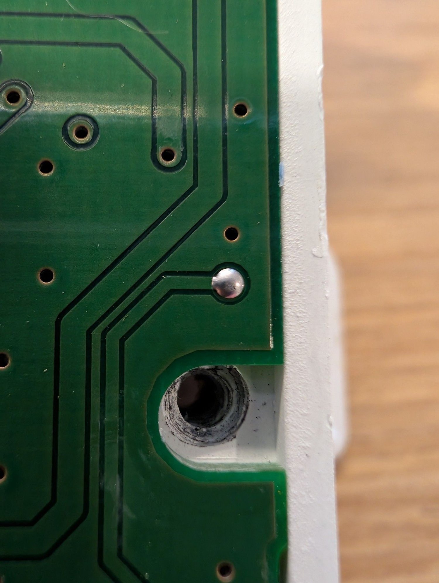

Update: I checked the Instrument Cluster rework, and it seems like it was already done, or likely out of the affected lot.
Still need to do a load test on the battery, but does anyone have anything else to check?
Thanks in advance
Jay
The M signifies ",modified" backplate
No indication of solder migration
