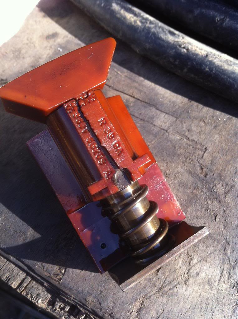

Well as you can see everything was going so well was just putting the new tensioner bolts in and one sheared while i was using a brand new teng tools torque wrench triple checked the torque setting and i must have had a crap bolt!

Take the other bolt out and you may be able to remove the tensioner depending on how much bolt remains in the tensioner body. If it is too long to slide off the bolt you are going to have to remove the exhaust cam sprocket to get enough room under the chain. Without any tension on the bolt it should just screw out unless it is broken off down in the threaded hole.
Don't know if you have cam alignment tools or are using the zip tie method but either should allow you to remove the tensioner.

Thanks for the help. Took the other bolt out and got a centre punch and needle nose pliers and 2 hours and managed to get it out. Im sure the bolt was bad and i didnt trust the other bolts after that so decided to use the original bolts and cut them shorter.
Everything was going well. And it just broke i cant blame the torque wrench or myself as i checked and triple checked so it was a bad bolt. They looked a bit cheap so im not very happy with berkshire jags for supplying them, the originals are of a much better wuality so thought i would be safer with those.
Got it all back together and it runs good so im happy.
Took 6 hours to do but pleased its done, the tensioner was cracked on one side but on the drivers side it was cracked all the way down and the shoe was missing and the you can see where the chain has been rubbing on the metal. so im glad i did it.

Yeah i can't believe how bad it was when i got it removed you can even see where the chain has been rubbing on the metal where the shoe has should have been. i hope to shoe is in the sump and not gonna cause a problem.

Who ever sold you those bolts needs a good slap! Glad you got it sorted out and by the looks of the old tensioner, just in time. I'd drop the oil pan you probably have bits floating around you need to remove. Another XK8 saved from the wreckers, Yeah!
