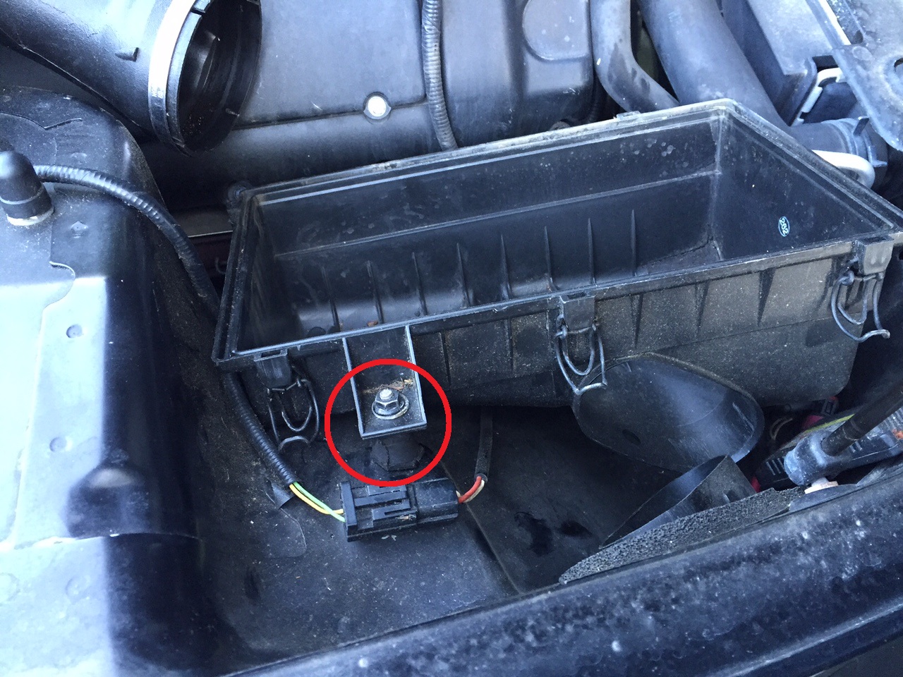

Hi Guys
can anyone help me understand how can i take off this bolt ( marked in red)
its attached to a rubber mount that spins as soon as i try to take it off.
its a 2001 XKR
THANKS

There is a VERY thin hex nut attached to the top of the rubber, under the plastic air-box flange. Grab it with a open -end wrench or a pair of vise-grips.

i got it - never saw the stupid nut
thanks

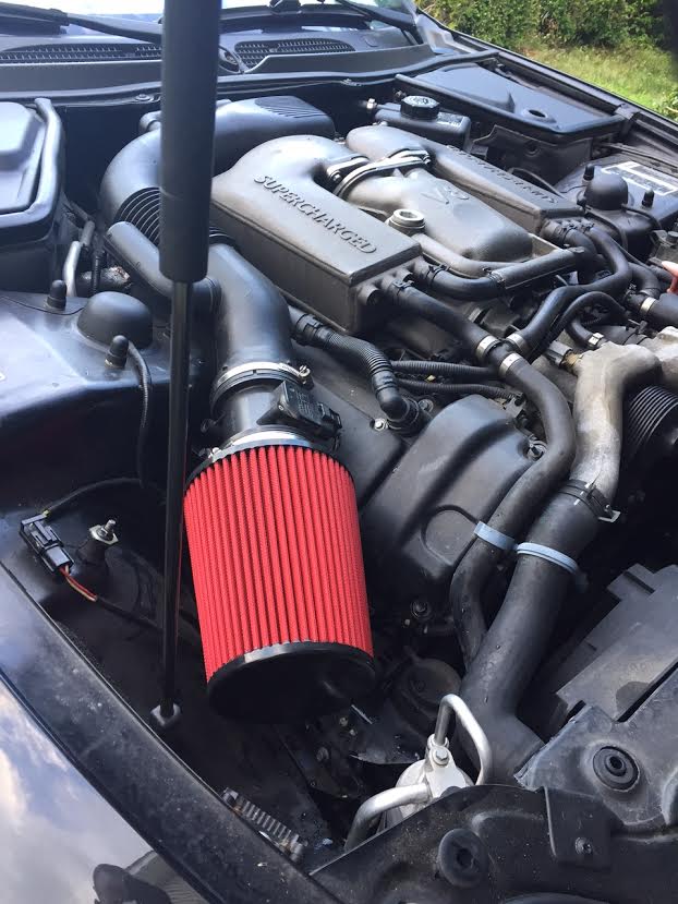

Attached photos , what do you think?
will water from the vents on the hood and / or engine heat can harm this filter?
Attached Thumbnails Help in taking out air filter box-unnamed-10-.jpg   Help in taking out air filter box-unnamed-11-.jpg
I think it looks nice and probably sounds a little throaty BUT, you are now going to be drawing in warm/hot air into that engine not the cool air it needs to run at it's best. While the standard Jag airbox may not look cool it actually provides cool air. I've measured the intake air temp with my Ultraguage and on the open road not stuck in traffic even on a warm day the intake temp is only a little above ambient. Received wisdom is that the cone filter like as not wont give you any increased horses either. There are cone filters that also have an attachment for a cold air intake duct.

thanks for the info worrasf.
which cone filter would you recommend ?
No recommendations from me I'm afraid as I stick to the OEM box. I had a dalliance with a piper cross on my Eunos but went back to the OEM box there as well. Other forum members may have suggestions but probably best trawling ebay

There are quite a few threads addressing this very issue. The link above has a dozen or so photos of similar installs, notice several of them where they isolated the corner to create a cold air box. From my research on the forum it seems our cars can benefit from more breathing room....bored TB, 3.5" intake, larger MAF, etc. Interesting.
