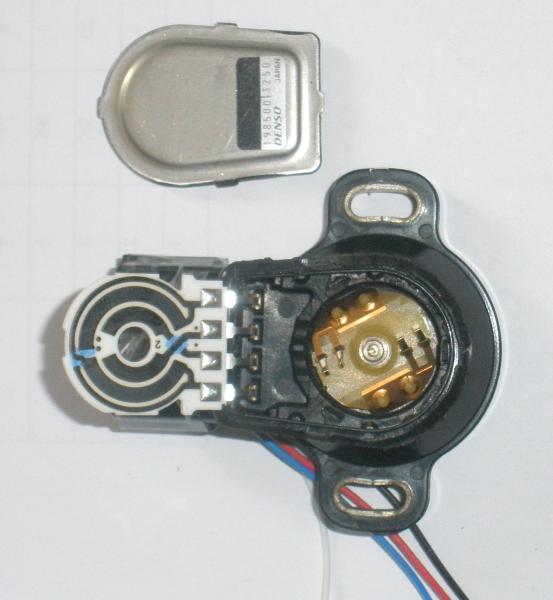

I have just had a look at the cable and it looks ok, where is the throttle position sensor located?.
Old Dec 30, 2022 | 06:09 AM
Kuddlesworth's Avatar
Joined: May 2021
Posts: 752
Likes: 226
From: Lincolnshire
On the side of the cast aluminium throttle itself. It's on the outside and looks like this 21884d1343646445-tps-replacement-p7300002.jpg (553×600) (jaguarforums.com)

Thanks for the reply, it looks like it is adjustable.
