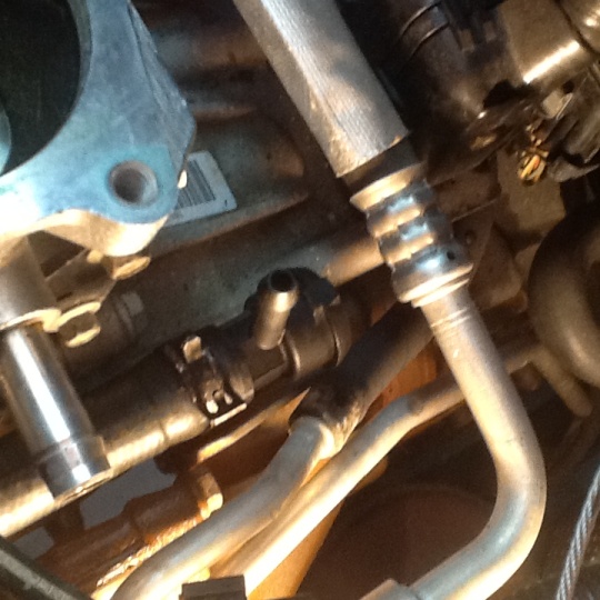

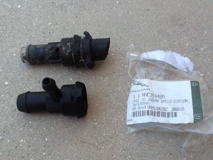

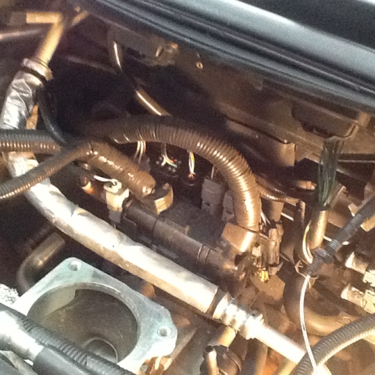

I just replaced my octopus hose & did remove the throttle body. As you can see by the pic, you have a lot more room to both remove the hose and then wrangle the new octopus hose back in place behind everything else that is in the way. It definitely made the job much easier and I highly recommend it.
As for the 3 way connector, when I tried to get the hoses off, it actually started to crumble in my hands. As you can see from the pic, the connector on top broke completely off. Mine is a 97 and the plastics in these early cars are now very brittle just because of age let alone the heat they have been exposed to. I think you will end up having to replace the 3 way connector. The new one looks very nice when it is installed.
Best of luck to you on your project.

Yea I ordered the plastic connector also. I think that is what is leaking on mine. I would think the TB is easy to get off on a 03?

Well I am not ready to take off an intake. I looked at this heater hose setup. YES the TB has to come off. ha ha ha. Do I want to take this on, ha ha ha ha.
How do the little silver fasteners come off the hoses to the TB, I assume they are reusable if taken off correctly.
What is involved in pulling off the TB? Do I have to depressurize gas line or anything?
The way the hose is made, the way the appear to GLUE the hoses to the hoses, that crap holds up over time????
The hosing appears to go under wires and **** behind the TB, I guess I just need to take my time and make it a weekend project?
