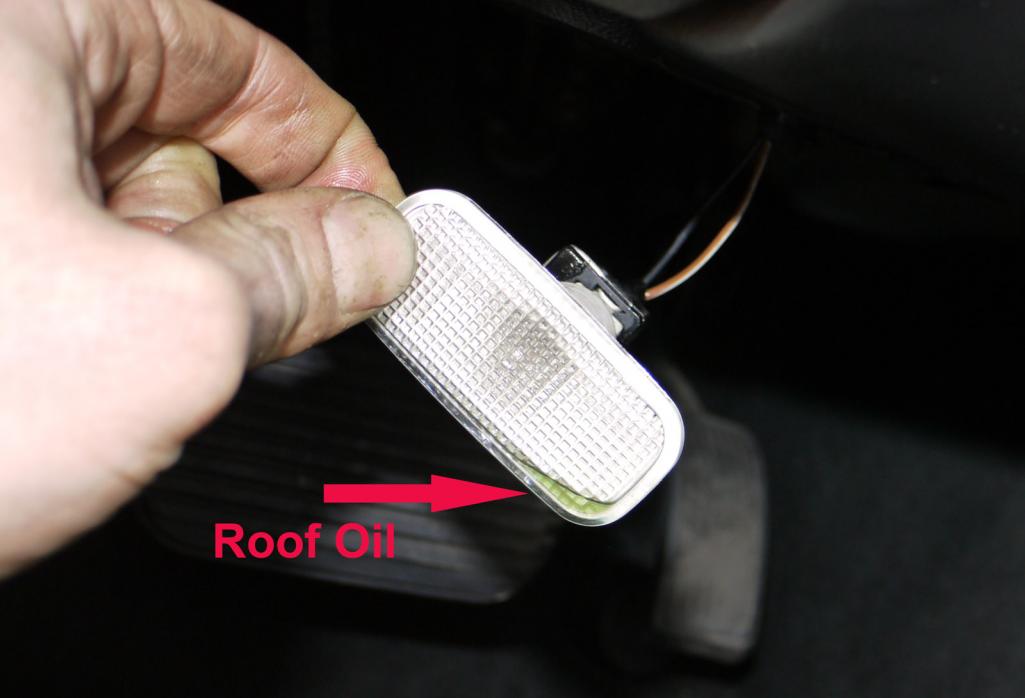

After all the talk about leaky convertible line, I went ahead and made things even worse!
1. There was a slow green oil leak, over driver's feet at my XKR. I was told that this is due to some line splicing, supposedly done by some dealer..

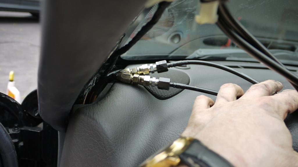

2. True, there were two compression fitted quick connects, one on each line, in the area of left pillar. This is where oil was slowly leaking down the lines, over some electric cables and onto my feet.
3. I decided to redo compression fittings, where plastic line screws onto them and accidentally snapped one of the screws that goes into the plastic lines.
At this point I have option to try and find new fitting, or possibly replace the whole line perhaps?
The upper line, where the fitting was connected looks perfect and new, however the lower lines that go all the way to the pump look old and oily, with black outer insulation peeling off.
Please suggest what do to and where to get parts!!! Thanks again, as always!

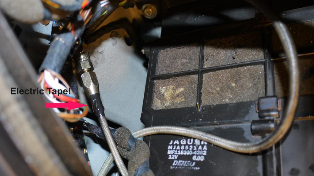

Mine had electric tape around the cut hose, so it fits tighter inside the fitting, how crappy is that!?
Also, as I uncovered the rest of the hose, it was already sweating oil through, in multiple places, along the way to the pump.

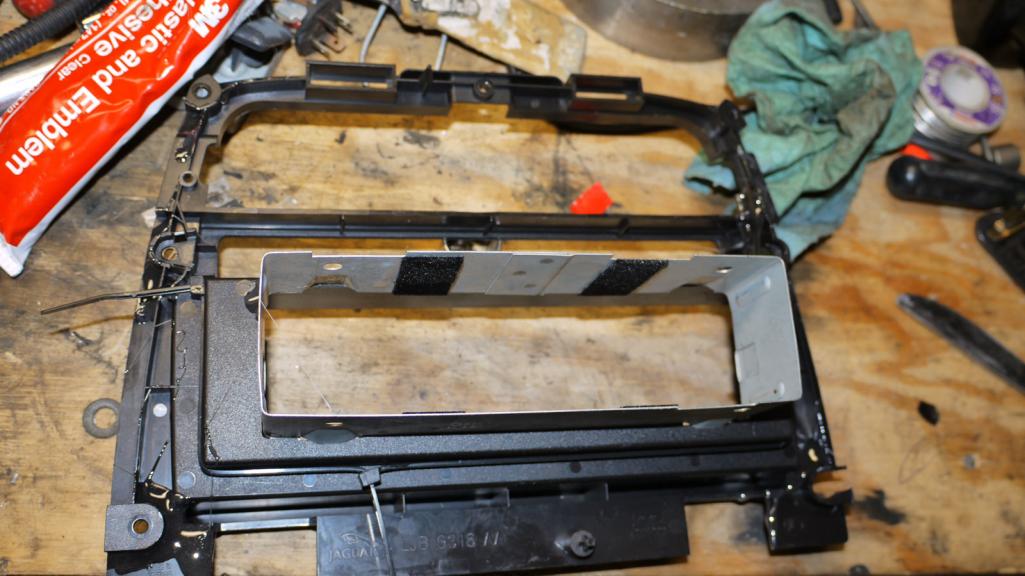

BTW, this job is not hard at all, if I was not fixing 5 other things on the way (ashtray, broken plastic brackets, steering column motor, rusty hole in the floor, replacing J-gate, welding cracked lower seat frame...), I'd be done in 3-4 hours, while watching kids go crazy in the yard.

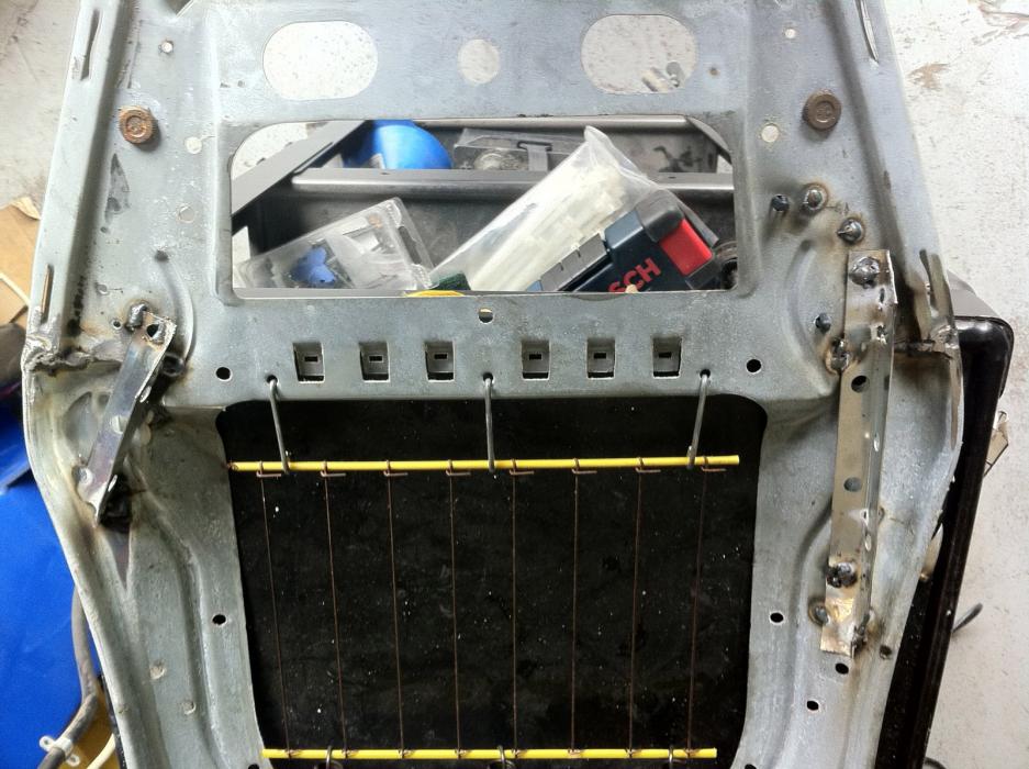

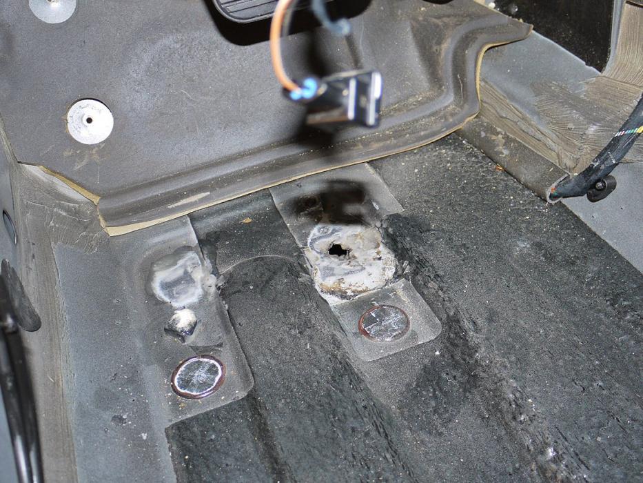

Maybe I spoke too soon about 3-4 hours. This job is very annoying and tidious. I am all the way back, at the right rear corner and it is too dark in garage to continue. My eyes are not what they used to be, no more cat vision for me
I did fix hole in the floor and broken seat frame, from previous owner's fat can! I loved welding that seat frame, it went like butter
The factory uses duct tape, useally black I use whats in stock, black or gray..
Its used in a few areas, especially around corners to protect from abrasion and hold in place, I meen there is a reason its called 200mph tape!!!!!
Old May 2, 2011 | 09:20 AM
Mish_Mish's Avatar
Joined: Jan 2011
Posts: 883
Likes: 173
From: Columbus, OH
The reason why they used electric tape under screw-in compression fitting, was because original black outer jacket already rotted off the factory hoses. So to make fitting snug, they wrapped tape around, instead of replacing the entire hoses, like they should have.
