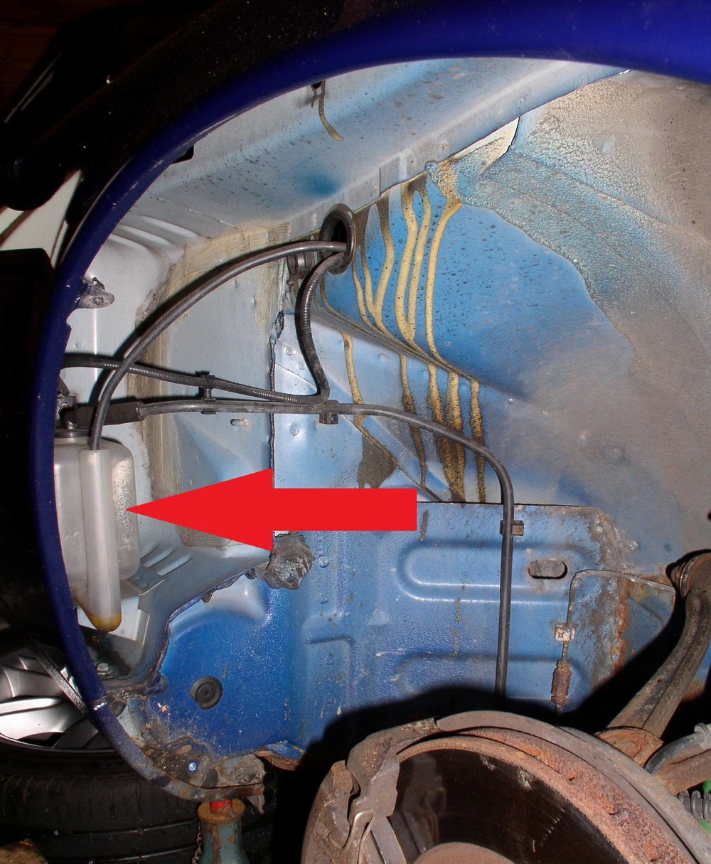

I have had my XK8 for just 2 weeks and have been checking the coolant level regularly.
I top up to the top of the expansion tank, but when I check it next time, it it's always 30-40 mm below the top.
Is it suppose to be at the top of the tank all the time?
I haven't checked the recovery tank that GGG mentioned as I didn't know it existed.
I assumed that overflow went to ground.
So if the recovery tank is working, [haven't checked yet] should the level in tank be at the top all the time?
Old Jan 22, 2018 | 06:14 AM
jeremys's Avatar
Joined: Oct 2014
Posts: 488
Likes: 73
From: Milton NJ. USA
ORIGINALLY posted BY FMERTZ
"Besides the black tank near the strut tower on the driver side (where the cap is), there is an overflow tank in the driver side front wheel well. It can be seen/reached by removing the plastic liner. My understanding is that this wheel well tank is not under pressure. It captures whatever goes past the cap when hot, and provides a ready made supply when the cooling system sucks the fluid back in during cool down. I assume that the normal operation of this tank could technically produce a smell, even if there are no leaks. Are you in need of refilling the system on a regular basis?
As you found out, there are a number of "usual suspects" for coolant leaks. You could add the radiator end tanks and the water pump to the list.
Separately, if you start meddling with this, you might want to look into the whole thermostat tower, including the upgraded aluminum model. Fairly easy DIY, and parts are not that expensive."
Hope you find this helpful, I know I did
Jeremy
Old Jan 22, 2018 | 08:37 AM
Likes: 17,005
Originally Posted by Mark Oz
..... I haven't checked the recovery tank that GGG mentioned as I didn't know it existed.
Originally Posted by jeremys
.....My understanding is that this wheel well tank is not under pressure. It captures whatever goes past the cap when hot, and provides a ready made supply when the cooling system sucks the fluid back in during cool down. .....
EXACTLY. It's the Atmospheric Recovery Bottle and as this awkward name at least confirms, it's not under pressure.
The level in the Expansion Tank should always be at the bottom of the filler neck when cold. The Atmospheric Recovery Bottle can be anywhere between an inch to half full. There is no right or wrong level for the contents.
