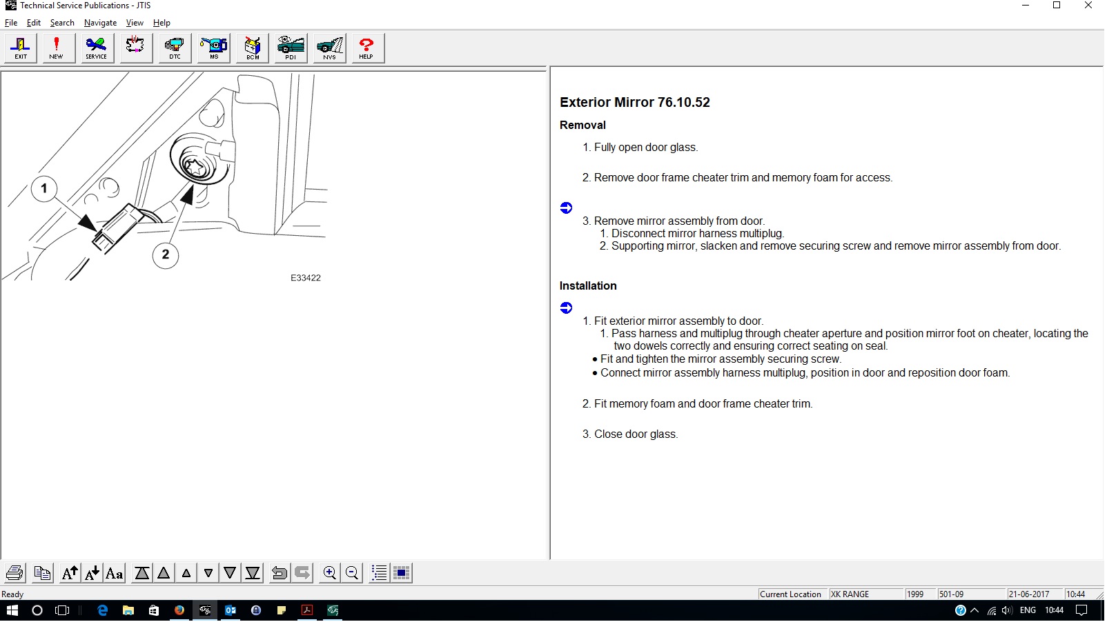

From the schematics it appears the connector will depend on whether the vehicle has powerfold and memory door mirrors.
I presume you've asked the question because you need to source a replacement? For the minimal work involved in accessing the mirror multiplug, I'd be checking it:

I will have to open anf have a closer look.
What kind of program are you using - is it downloadable somewhere?

re the screenshot in Graham's post, it's from the JTIS. You'll find it here (link near the top):
https://www.jaguarforums.com/forum/x...ts-data-29800/
