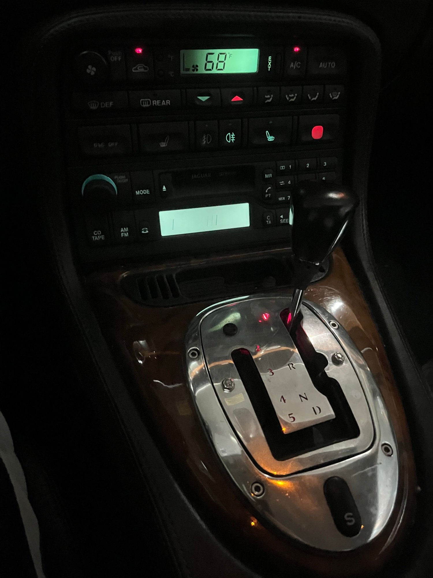

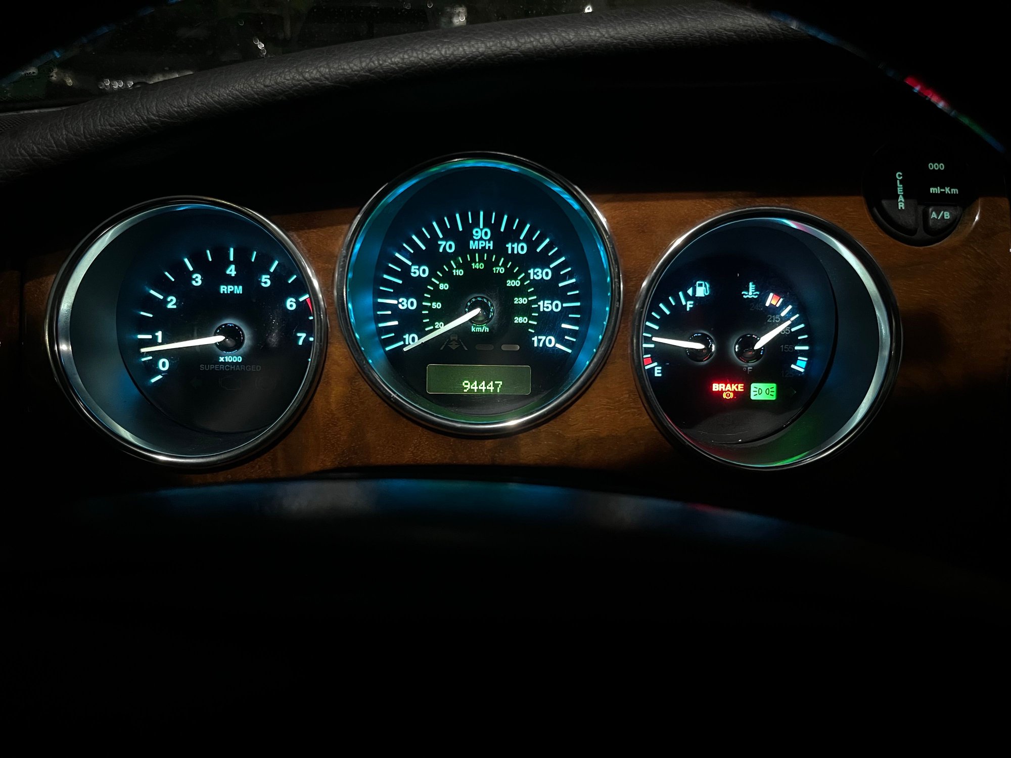

Last night I replaced the instrument cluster light bulbs with LEDs. I went with the 194 Cool white LEDs for the main bulbs, and incandescents for the type 37. It looks good. Now I want to do all the center console bulbs including climate control, the radio headunit, and the center strip that has the hazards, the seat warms, traction control etc.
Does anyone know the total number of T3 and T4 LED bulbs I need? The OE bulbs are sleeved to produce the color if I understand correctly. So, that would mean there's at least 3 LEDs that will have a different color from the rest: reduce temperature button (blue), increase temperature button (red), and the hazards button (red). I'm hoping the white LEDs in the center console will match the ones I've got in the dashboard.

Perfect, this is the information I needed. Could you post a picture of how the console looks with the all-white LEDs?

Happy to post, but note that the 2 leds in the middle (temp up and down) have since stopped working. Also, the hazard switch used to glow, and that has stopped too (although it flashes when in operation). Never a dull moment with these cars 😜

The color seems a perfect match with my dashboard. How long did those LEDs last?
Why didn't you also replace the ones on the radio headunit? That color and brightness mismatch would absolutely drive me crazy.
I plan on changing mine but haven't found information on what type of bulb the headunit used, although I assume it must be the same T3 and T4.
I think that I will have to accept the ones on the door switch pack being mismatched because of the possibility of not being able to reassemble it.
