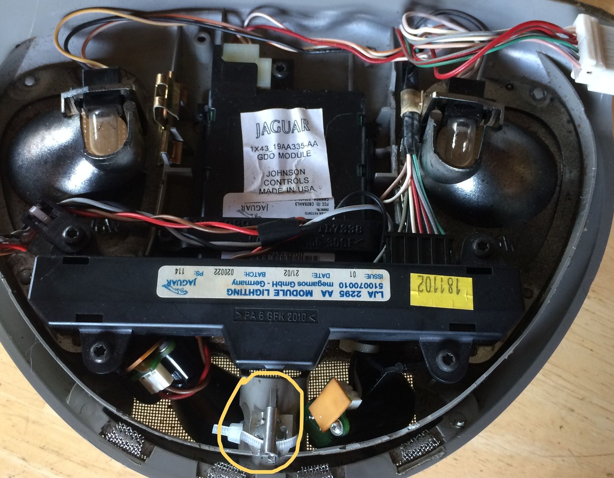

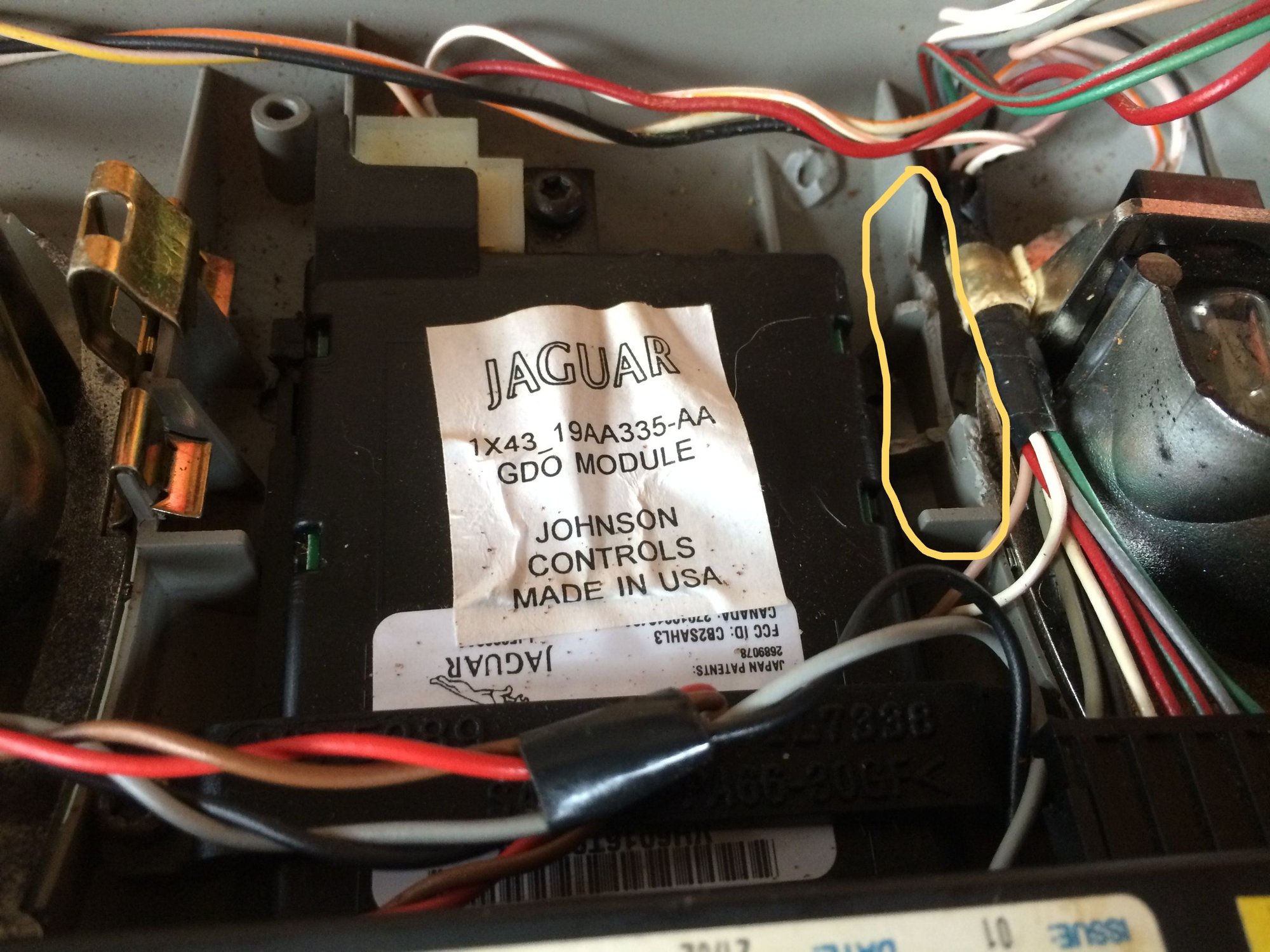

Thanks for the advice and opinions folks. I appreciate it. I haven't yet gotten the car to the tire shop as I am trying to repair the roof console that was broken loose before taking it. Can't find one of the same color and I don't really need the electronics, just the housing but it doesn't appear available that way. So repair attempts are underway to fix the anchor points for the snapped off tabs for the spring clips. A new roof mounting block arrived last week to replace the one that was snapped in half by the impact. I think I have fixed one clip location but still have to figure out the other.
Mount location with snapped off mount pieces still under the screws.
broken tabs for the spring clips!
broken rear spring clip tab
broken spring clip tab for mount block
one replaced clip

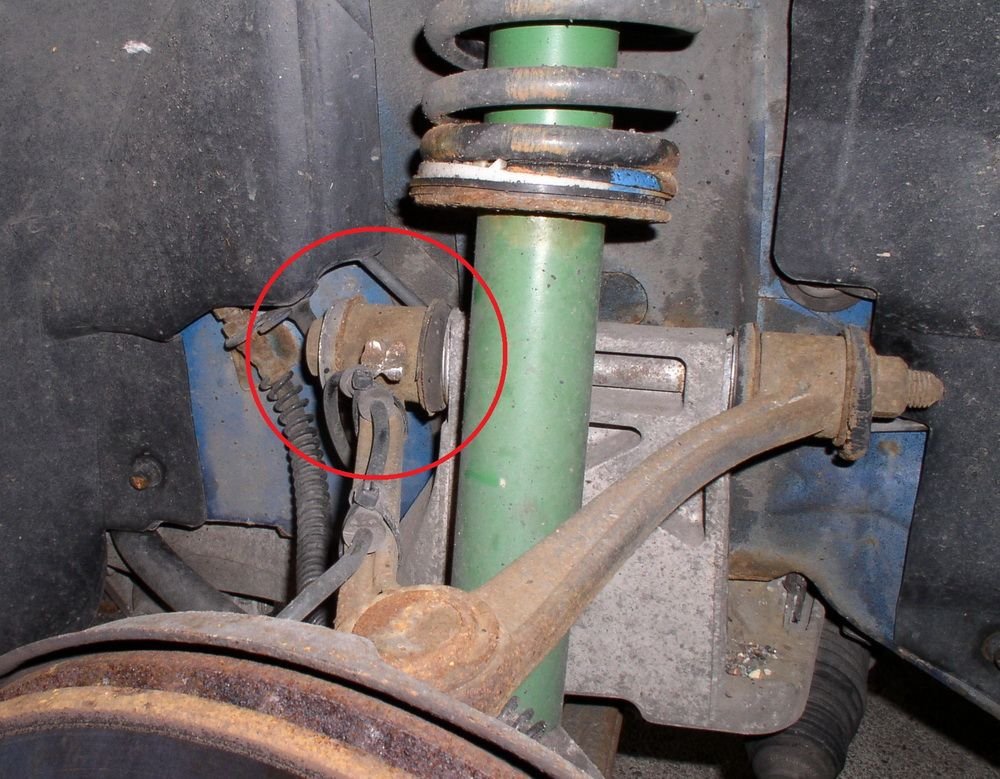

Originally Posted by XK8 Rebel
...... The shop seemed to think something was bent but did say replacing worn bushings, shock mounts and other rubber components might get it close enough to allow a proper alignment. ......
I think "bent" suspension is unlikely although a distorted wheel is a high probability. The aluminium crossbeam is known to crack under severe impact and similarly the cast iron wishbones will shear if overstressed. Here's an example:
Although the XK8 front suspension is structurally "robust", it is hard on bushes. The Upper Wishbone bushes can last as little as 15K miles.
