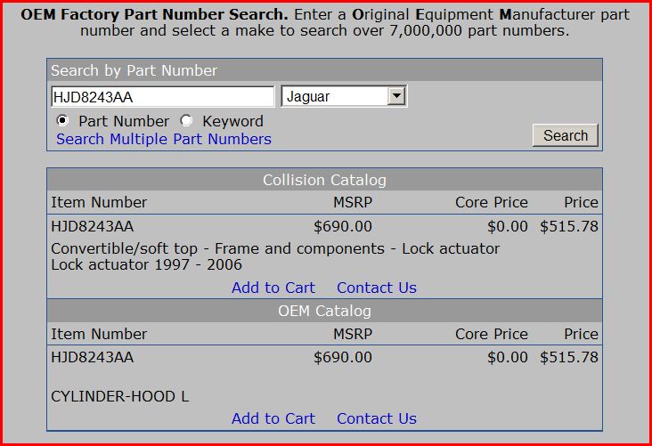

Originally Posted by 1999XK8
What is that part actually called so I can hunt for it?
Ron
From www.Parts.com
