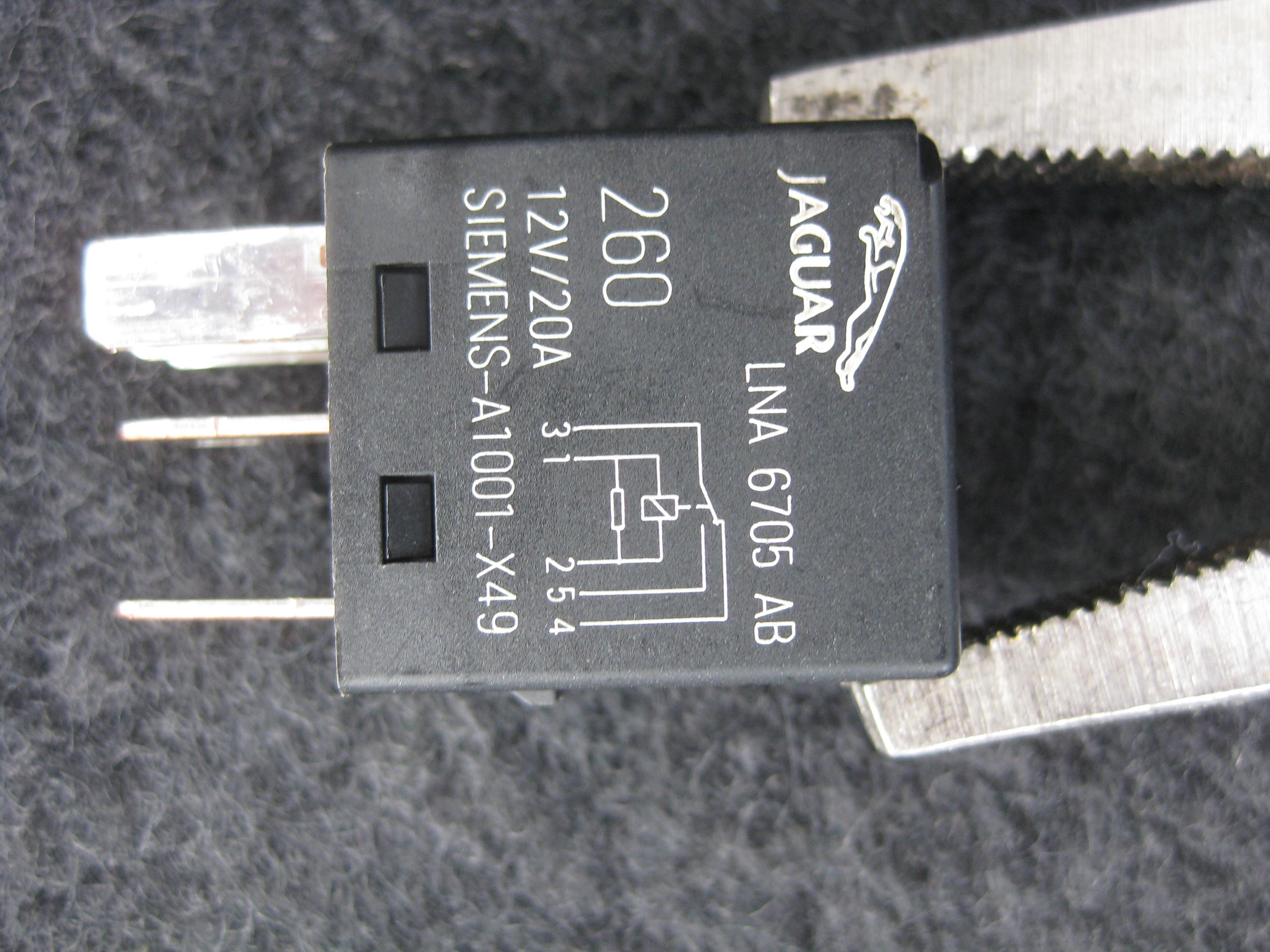

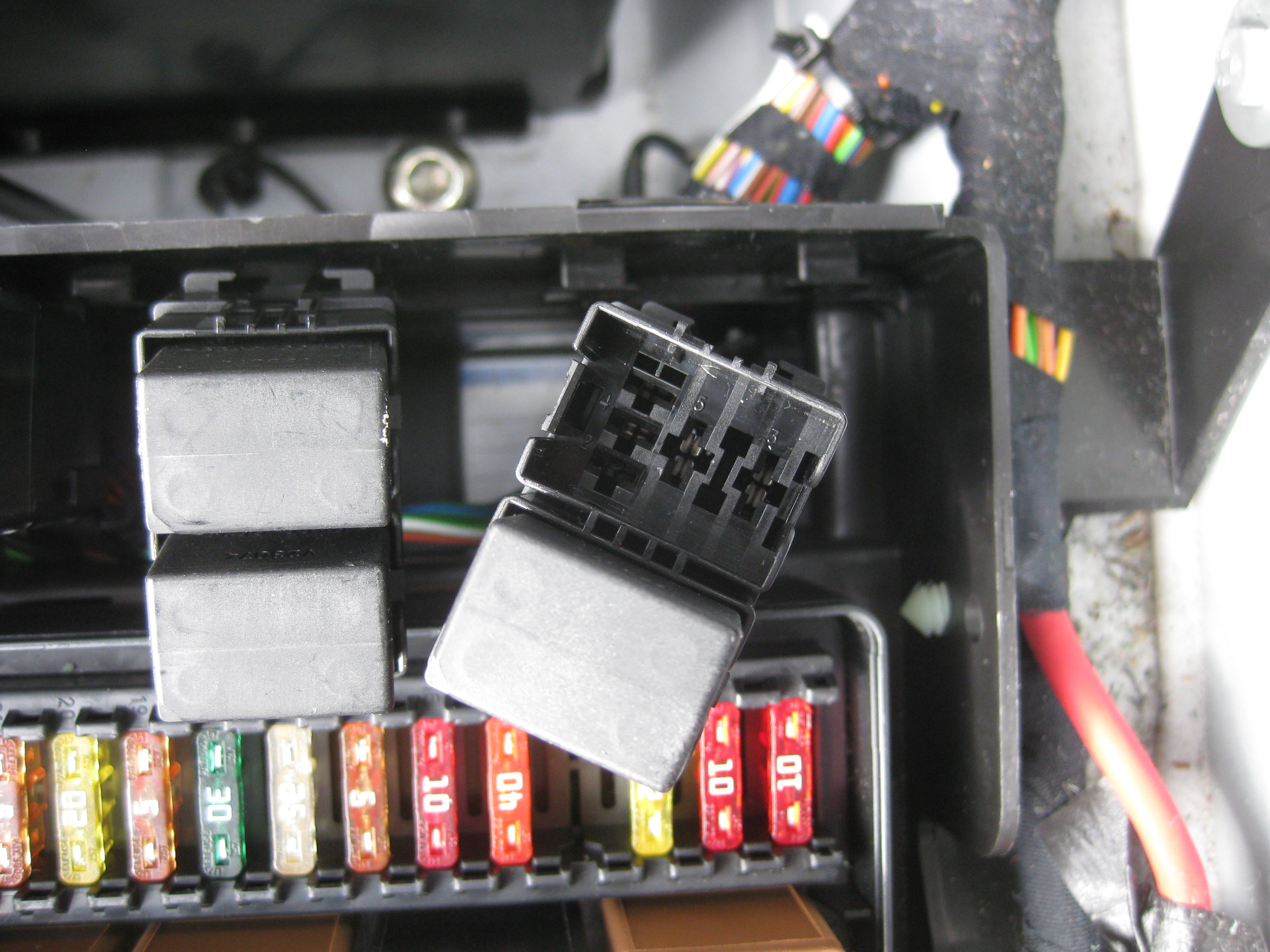

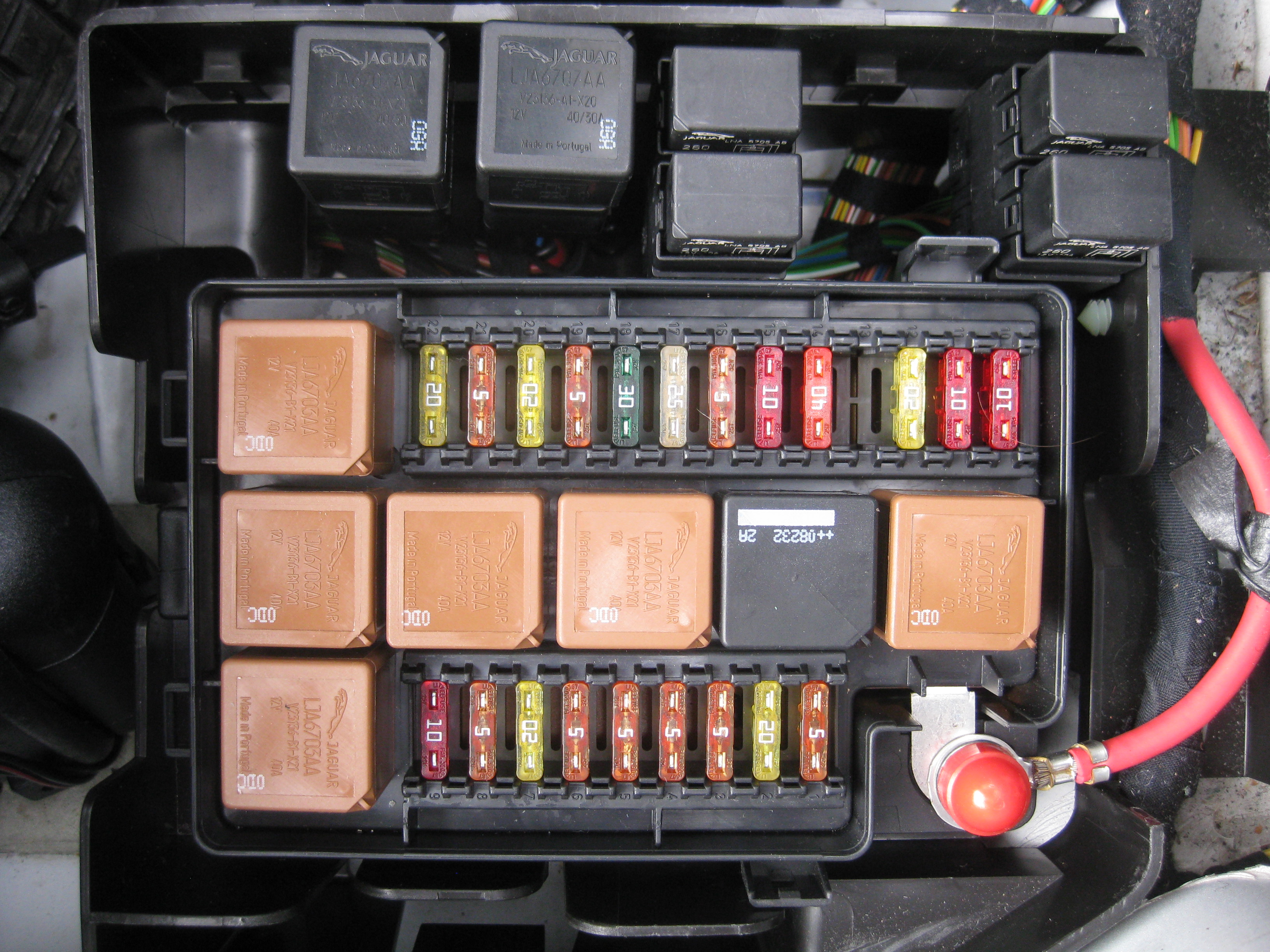

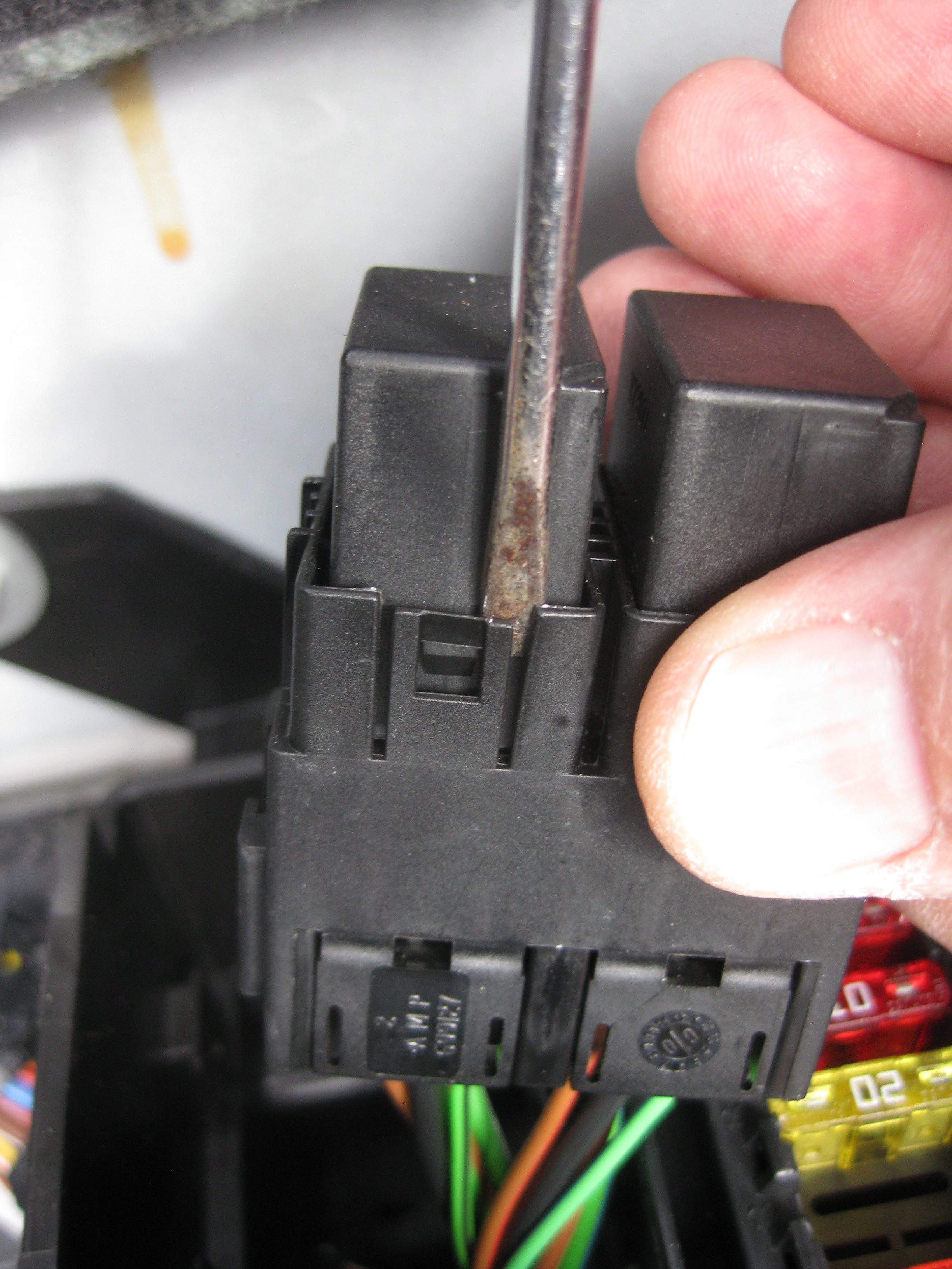

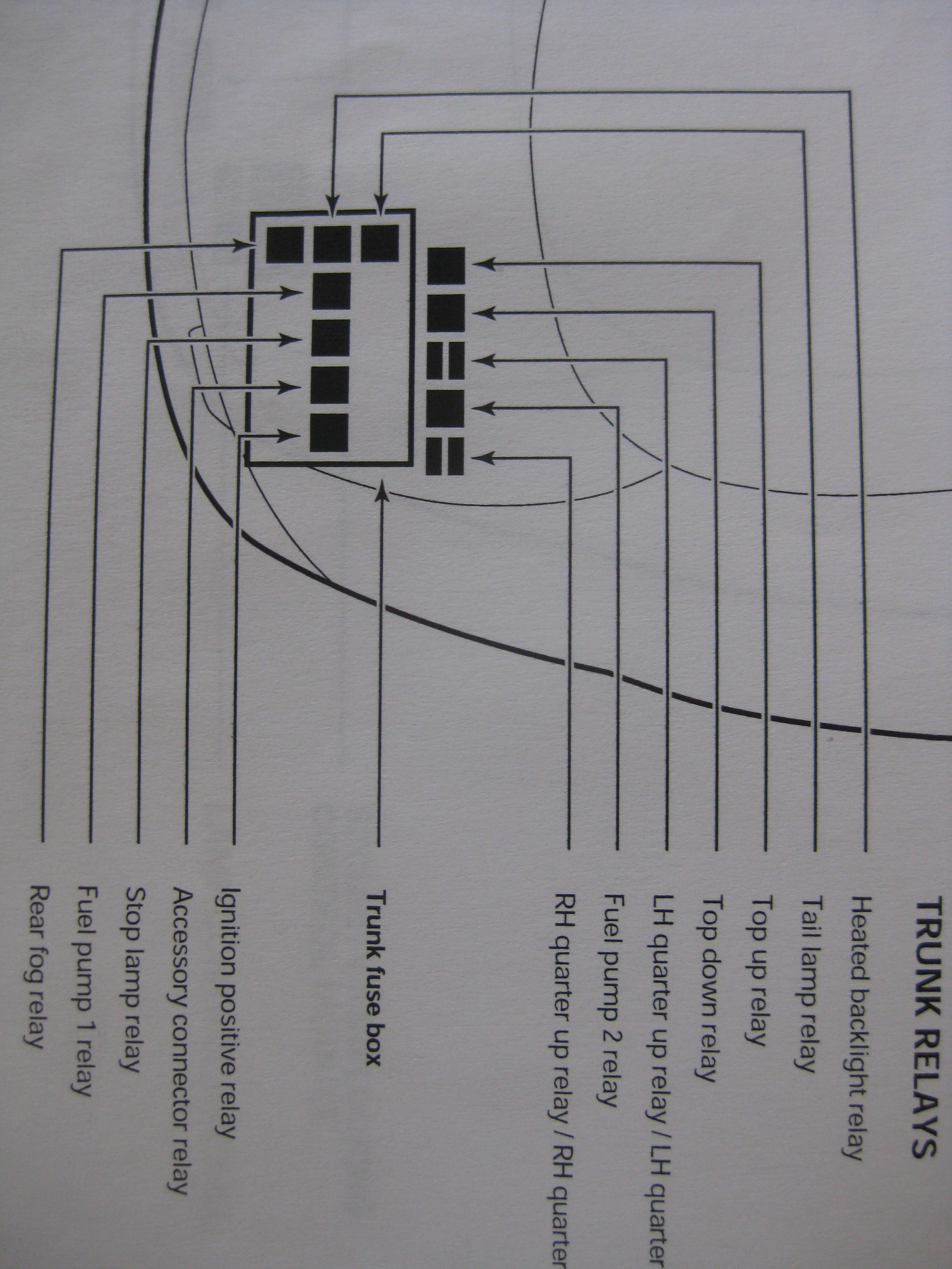

to raise quarter windows, pull out the up relays. need to release clip and then grab the fuse with pliers to pull out

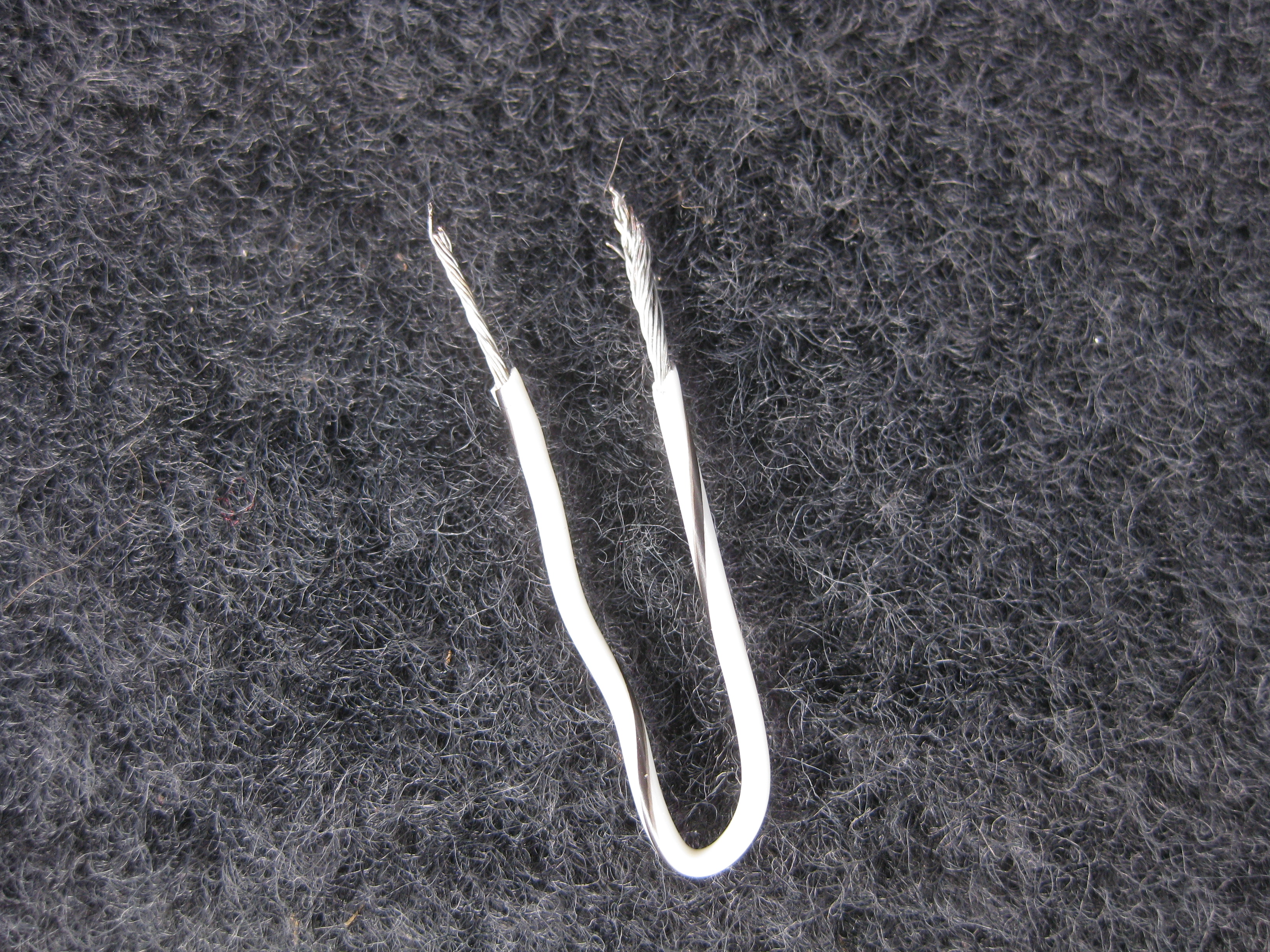

jump pin 3 to 5

and the other
