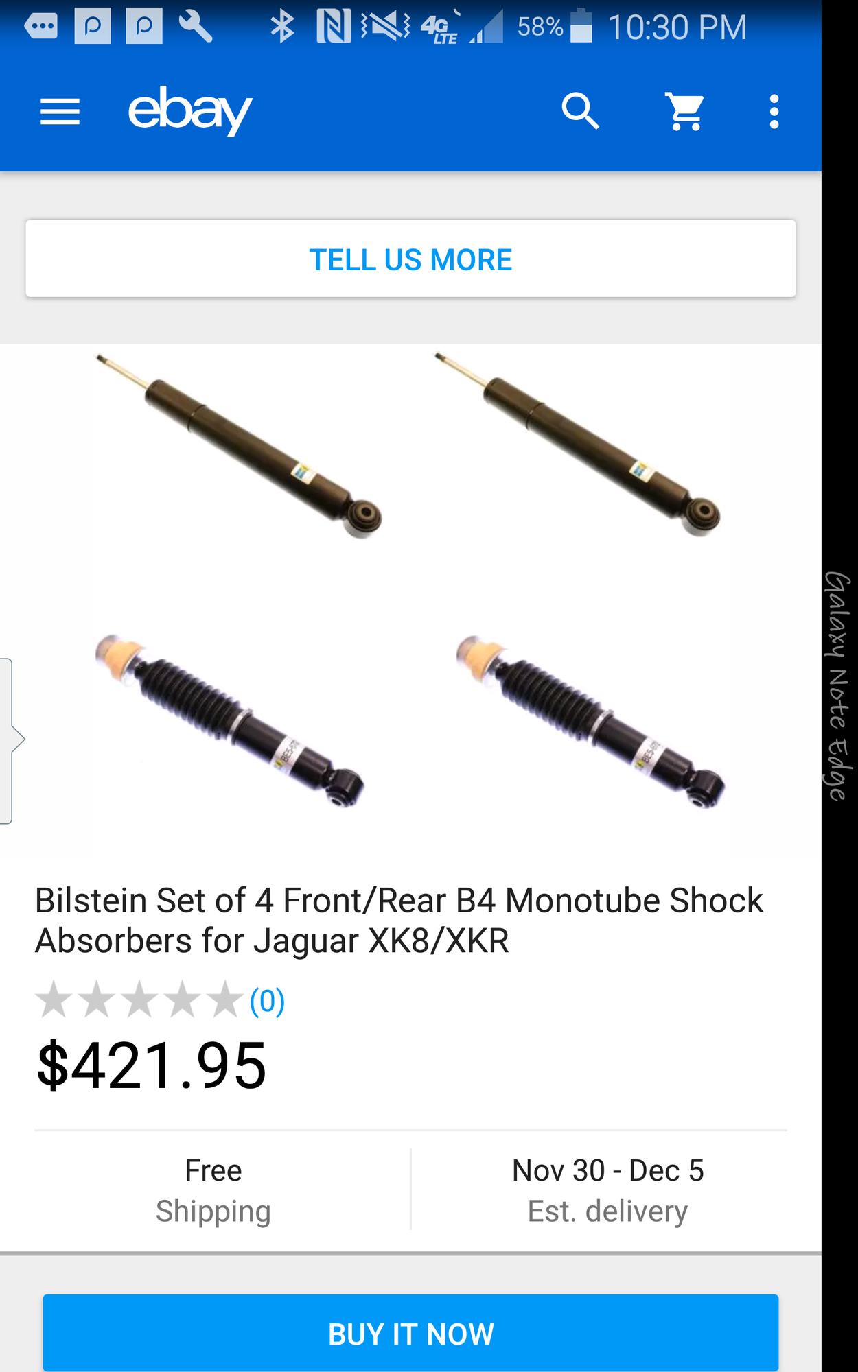

I found these on ebay. It's a set of the front and rear. I think I'm going to do those as well while I'm at it and perhaps if the sway bar bushings are good they were on the front driver upper a arm bushings were good as well. Let me know what you guys think of this kit and if reusing the stock springs will be ok. Thanks again
Marc

Marc, that is a good price, so go for it and get the top front shock mounts also.
Jon89 and I put in the poly ones on his and he is very pleased. Get the ones off Ebay that are put together, the others are a pain. Use a good coating of silicone grease on anything poly.
Wayne

$105/shock shipped is about the going rate for shocks. The fronts don't come with new boots/bump stops. You can get these aftermarket for around $10 each.

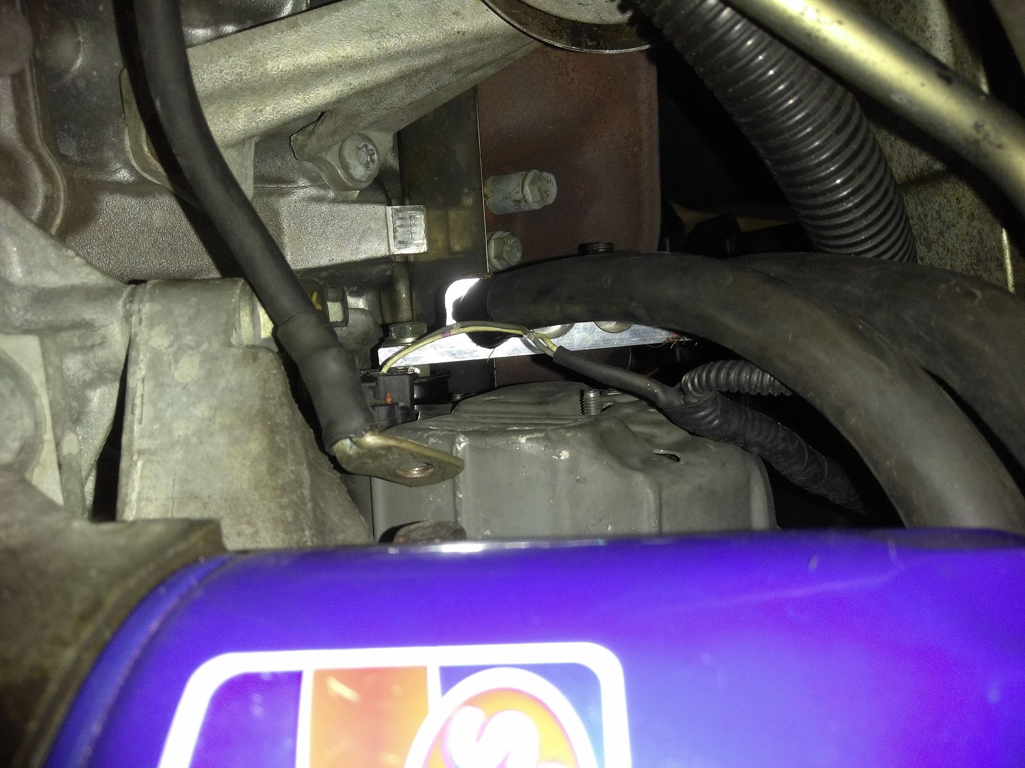

Haha batteries won't be any problem. I have 4 of them now. I sold one as I think it was putting a strain on the alternator running those amps and trying to charge those batteries. But it is a custom made 200 amp but that's at 1800 rpm. I charge them every 2 weeks or every month. They drop to maybe 80 percent capacity. Wayne I live in Jacksonville FL. Anyway to the member asking about the system (I'm sorry I forgot your username) with the right wiring kit you should be able to use the factory Alpine amplifier with the new head unit.
This was such a PITA to figure where to route these wires and theres no way for the grommet on the driver side to fit any other way. It's 4/0 it's HUGE. Even if I trimmed it down some the 1/0 wire would be I'm the way. Perhaps another custom block? It runs across the shroud which is OK it doesn't get hot and it's grade A welding cable. The other side I did nicely and got the rubber grommets to fit back on perfectly i just cut a tiny slit in it. The silver tinned JL wire looks out of place but I didn't want the hood to crush it. It runs through the brake compartment through that grommet below the windshield weather stripping zip tied away from heat. It goes into the the other compartment where the ECU and TCU are. I know what you're thinking why would you do that???
1. There is a hole I drilled to get both 1/0 cables through the floor/firewall so I could run them under the carpet
2. The fuse blocks are in there with the TCU and ECU so there isn't any worry of anything shorting out and if those fuses blow then all of the electricity will stop flowing and prevent any damage. So far so good and the ones in the trunk that have been back there for a year haven't changed color or anything. Custom 4th order box I designed for my 2 Orion hcca subwoofers. Waiting on recones as I blew them. The guy didn't want to honor my warranty but since I had spent over 3 grand on equipment I said well you won't get my business again. Got the run around this isn't right that isn't right you probably haven't even added a battery I had 3 back there to begin with that came out of my other car that was wrecked. Long story short recones will be here next week and they are drop in. thank God
This box will play all sorts of music it's not just for booming rap. It'll play classical rock country anything and sound great. It is a sealed box inside a ported box. The speakers are going to sit in the sealed chamber (or I may invert them so the magnet sticks out and the pole can vent through the port) and this will provide a nice flat response that sealed boxes have while getting loud and moving air like a ported box.
Don't know if you can actually see it but this is the birth sheet to my old school Rockford 800a4 punch. Not effecient due to being a class a/b but paired with the re triple x components ugh..
You have to hear it; it sounds absolutely beautiful. I know I'll regret this when I'm older but it's not the bass that makes you go deaf. It's the door speakers! We don't normally hear frequencies that low and I know very few people that talk that low. This has the hpf (high pass filter) on the radio set to 120hz so nothing below that will play through my door speakers. No bass just high mid bass.
​​​ I tried to make this look as factory as possible. I have 2 4/0 welding cables on a custom block I made at the machine shop with thick set screws like an amplifier has to hold the heavy cable in place. It works great I yanked on it and it's not going anywhere. Yes the one welding cable is running through the abs modulator but that doesn't move so it's fine and it runs across the fan shroud down past the intake to the alt block. The other one runs below the hood line and connects to the other box.
Sorry I didn't get the head unit in the picture. I just got a new phone I'll take one today. As you can see the voltage is above the middle 13 and with all the wire upgrades it actually sits at 14.3 with the AC and fans running full blast which was an incredible increase over factory. 14.6 14.7 without the AC/fans on.
Custom alt block I made on the CNC at work. Well I drew it out and the program translated it to g code and cut the part for me and even tapped the holes. Mastercam and toolpaths are awesome. I did attach the factory wire. Had to get a bolt from ace and make the hold on the lug larger Anyways this is what's up so far. I'm down 2 subs so no bass but the recones will be here next week hopefully and the box will fit right in my back seat and yes the convertible top will still go down (manually that is) :/
This is not for everyone I understand but I'm doing it for my brother he wanted to take the car to shows and audio competitions. Will be the loudest convertible jaguar hopefully! Going for a 150db hit 145 in that small prefab box with just 3 batteries.
