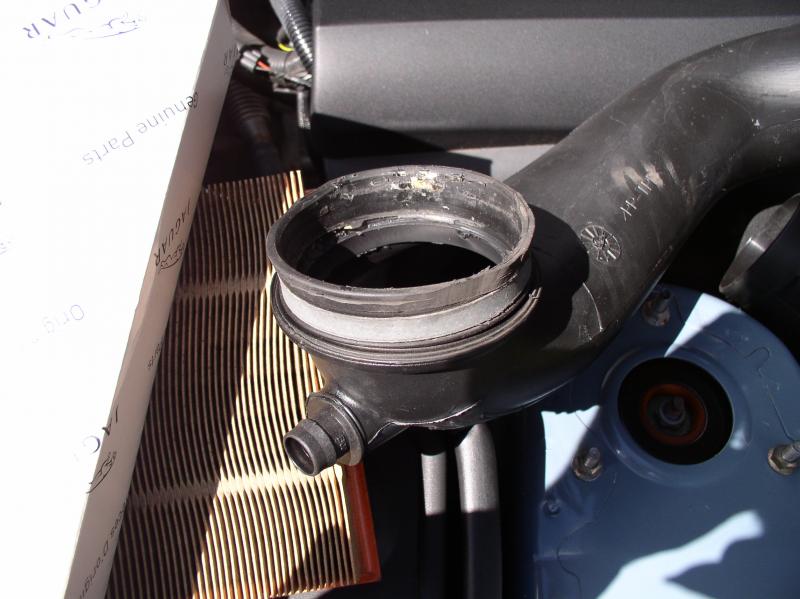

When I removed the Air Filter to TB trunking to change the filter, I found the TB end rubber seal appears to be heat damaged:
It's glazed and hardened.
The 4.2 trunk is secured with a Jubilee Clamp unlike the 4.0 which is held on with two bolts. Also appears to be a slightly different seal design. Never had this issue with the 4.0. Did you have any damage to this seal on your 4.2?

That looks awful. I wonder what would damage it like that?
Mine looked as new (unlike the TB itself - filthy wasn't the word).
If you've got an RS account there's 494-714 which really is snake oil in an aerosol.
That would fix it. You'd need to degrease first with acetone.

I think I'll replace it rather than attempt to clean it up. The rubber is almost brittle on one side. As yours is like new, this must be a one off.

Graham that rubber on the snorkle looks pretty beat up, wise idea to replace.

It is. Can't imagine how it's got heat damage. I've ordered a replacement today.

We all have frequent reason to grumble about Jaguar not fixing design faults but they've gone in the opposite direction with this Inlet Duct and made a perfectly satisfactory design worse!
The original 4.0 litre Duct had a push fit rubber seal at the TB end and the Duct was secured to the TB with two hexagon bolts. I never had a problem with this seal on my 2001 but it is available as a separate part from Jaguar.
The 4.2 litre Duct has a bonded seal at the TB end and is secured with a Jubilee Clip. The Duct is supplied complete by Jaguar and the seal is not available separately.
On closer examination this morning, what I thought was heat damage is actually hardened glue on the rubber seal.
Any ideas on a suitable solvent for cleaning glue off rubber?

It all depends on the glue.
Maybe start by soaking in hot water + washing up liquid to make the rubber more flexible + see if you can peel/work off the goo.
If that doesn't work then I'd guess the flexible is butyl rubber which is surprisingly resistant to most solvents.
You'd be safe trying alcohol, white spirit, petrol and acetone.
If they don't work then an aromatic like benzene (if you can get some).
If some clown's used silicone you can get silicone seal remover but I don't know what that would do to your rubber.

Steve,
A soak in warm water and washing up liquid followed by acetone ( Mrs G's nail varnish remover ) has done the trick.
The hardened old sealant peeled cleanly off the rubber and I finished off with Autoglym Vinyl & Rubber care. Good as new.
