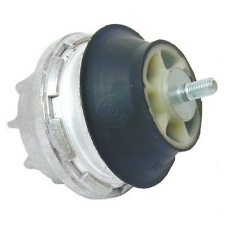

How exactly did the Mounts fail?
Breaking up at the rubber top / the castellated joint or by the gel leaking out?
