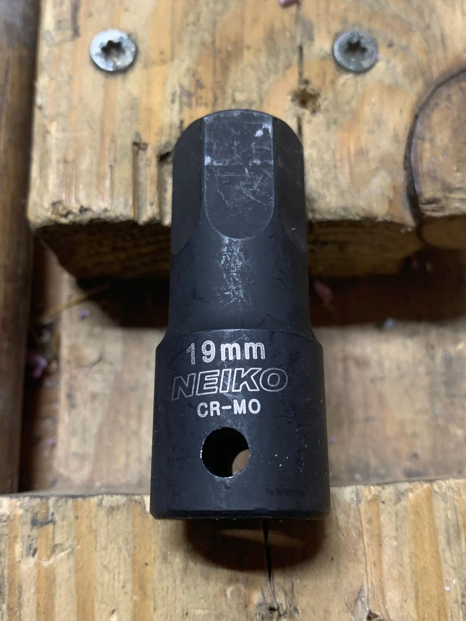

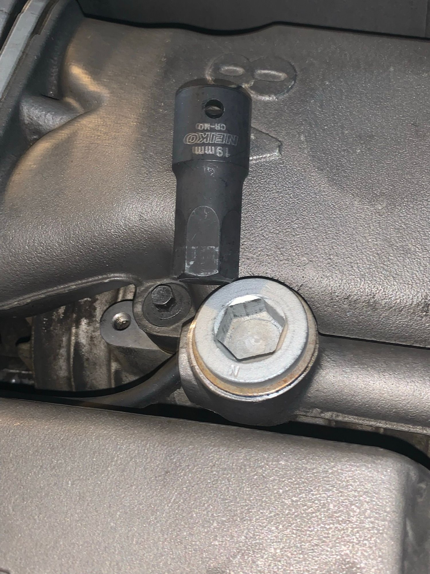

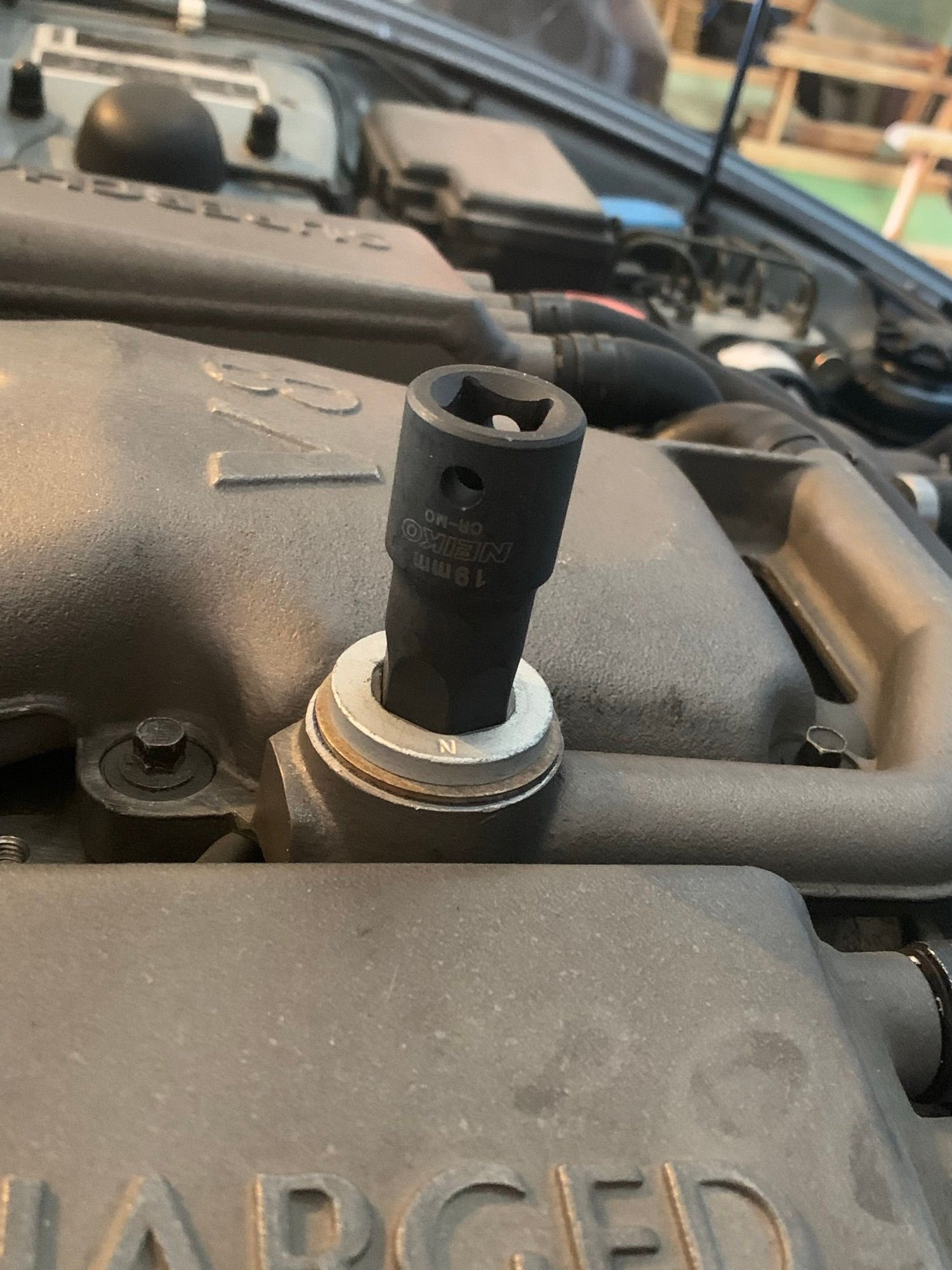

My scanner doesn't show this temperature. I wish it did though because that would be really nice. I need to invest in a better scanner I think. What one do you have? The hex bit came down that fits a 1/2" socket wrench or impact bit but I don't have one of them so I thought the bit would come out but it doesn't. I found a spark plug wrench and used that with it and got the plug open. I filled the intercooler up and went for a drive. I will let it cool down and try and see if more can get in there. I probably only put 1liter in at most so I figure it should take more than that. When I got back after a drive the intercoolers weren't cool cool probably around 50C like you said so maybe it needs more coolant in still. It was cool enough to the point I could keep my hands on it but I did only go for a 15 minute drive one way and 15 minutes the other way. I will probably do that tomorrow. I did try and squeeze the pipes to get the air out of the system but I'm sure there is still lots in there.
