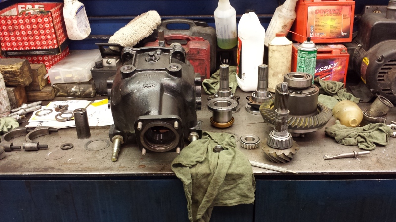

Thumbs up Differential progress
Just wanted to show you all a picture of the 15-HU differential before assembly. We had to make a few small changes the the pinion flange and shims. We are also experimenting with different fasteners for the axle flanges. The housing has been chemically striped and powder coated black. As you can see, the carrier is a Detroit Truetrac
More info coming soon..

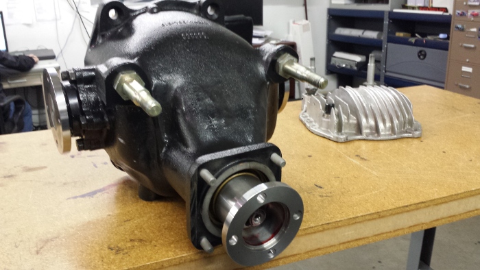

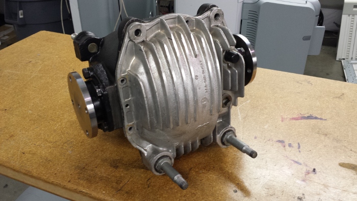

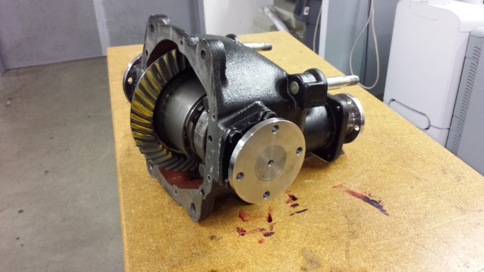

Exclamation Jag differential Update
Just a quick update,
The test mule is assembled and ready to install. Will be installing it and testing shortly. Will get back to you soon...

Please let us know how your LSD behaves vs Quaife gear-based unit others have used and the OS giken clutch type that others went with. I for one am into tight cornering and would love to pull off some controlled drifts as shown by Top Gear for the factory one off test mule XKR-R that had an LSD and a manual trans....

@Weisberg,
For some controlled diffs you can better use a clutch type one, as far as I can see the detroit truetrac is a ATB diff as is the Quaife.
@AJMotorworks,
What are the sizes of the 2 bearings on the pinion? This is another important point for the diff strenght, so am curious if these are bigger(/stronger) then the stock XKR ones?
