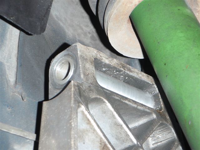

He's talking about the front suspension crossmember.
Dave, I've seen that on a few XJ40's, which are a steel fabricated crossmember, but it was never a case where it was bad enough to require repair.
You're going about it the right way for sure, I think an alloy casting like that can crack once it is getting hammered as a result of the play. The example I would cite for this is cracked alloy rear hub carriers that gave up after the lower fulcrum bearings had failed, and the hammering of the suspension loads did the rest of the damage.
I think if I had that car in my shop, I would look into using a reamer to resize the hole with the crossmember in place. I'm thinking along the lines of a kigpin reamer, like on the MG's. Then press in some bushings, maybe a connecting rod wrist pin bushing from something would be an appropriate size to use. Think that might work?

That looks sweet, but having to pull the crossmember makes it a pig of a job. It seems like there should be an adequate fix with it in the car, but your result is perfect.

Dave, what exact bushing did you end up using, and what size reamer? I am a do it yourselfer, so any specifics appreciated. I like your idea better than TIG welding it and reboring. I would appreciate help locating the correct bushing.
