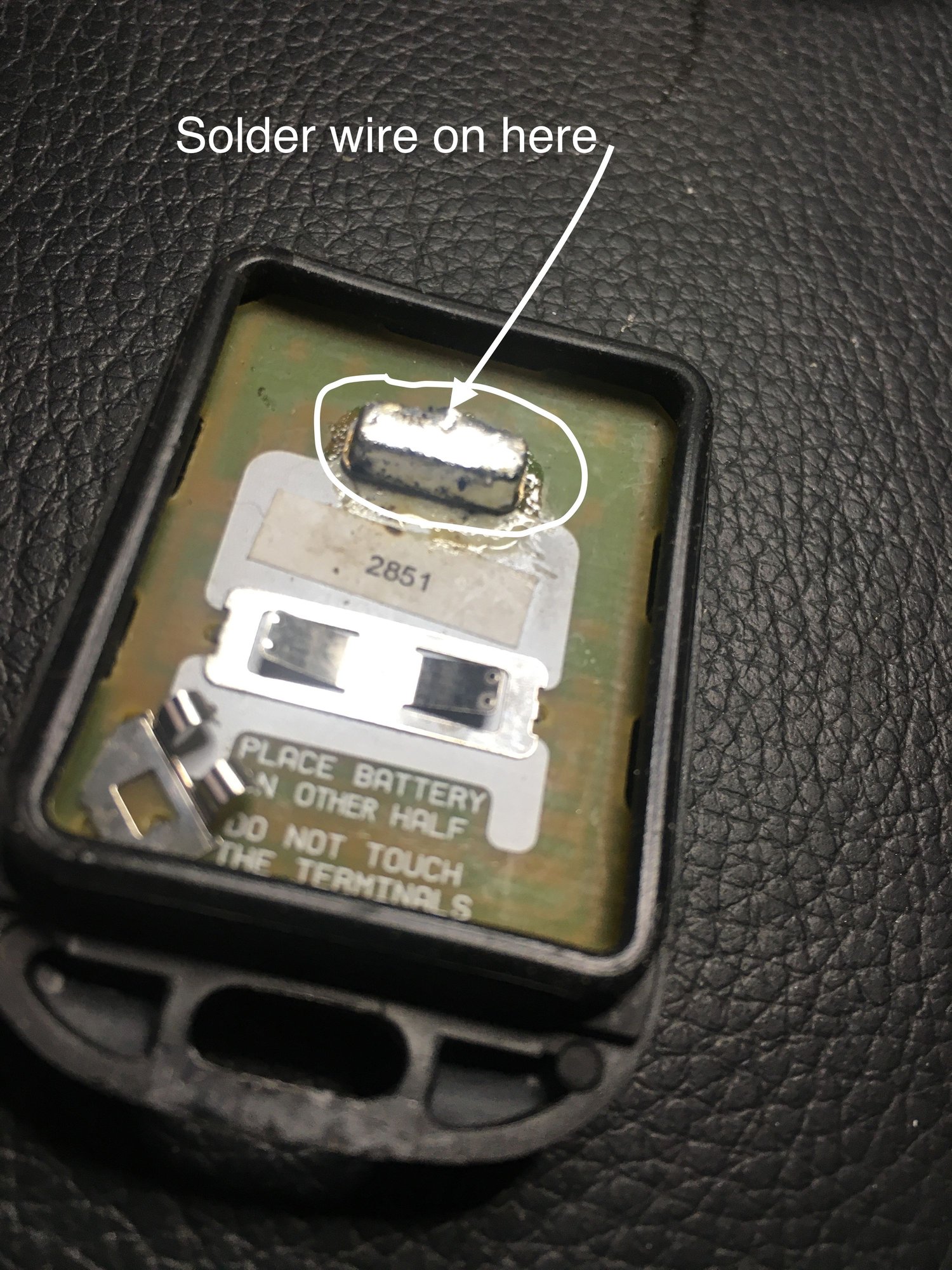

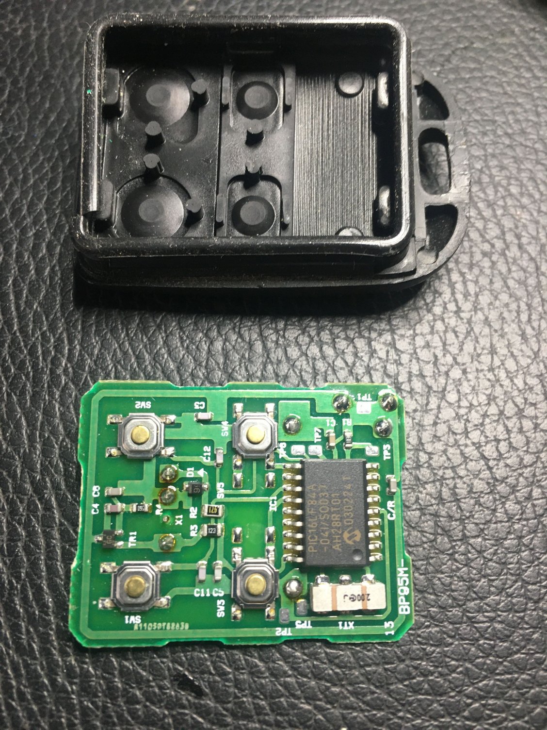

Like lots of the threads above, with of my 2005 XK8s key fobs have a range of around two feet.
I then saw some bright spark suggested soldering a small wire on the inside of the key fob, which I did, only just touched the solder onto the wire, fine....NEVER DO THIS, finished the fob off , even paid £40 on ebay to "automobile -locksmith" sent it back to me as dead as when I sent it, and although I had it checked at a local garage and the guy tested it and assured me that it was dead and was not transmitting, the guy who I sent it too kept saying it was fine, and now it is more or less impossible to get your money back through eBay as a buyer, another lesson learnt, be very wary of ebay unless you are sure you are dealing with a reputable dealer.
So Never....NAVER use this company, perhaps they are alright if you want a button changed, but otherwise the blokes a scammer.

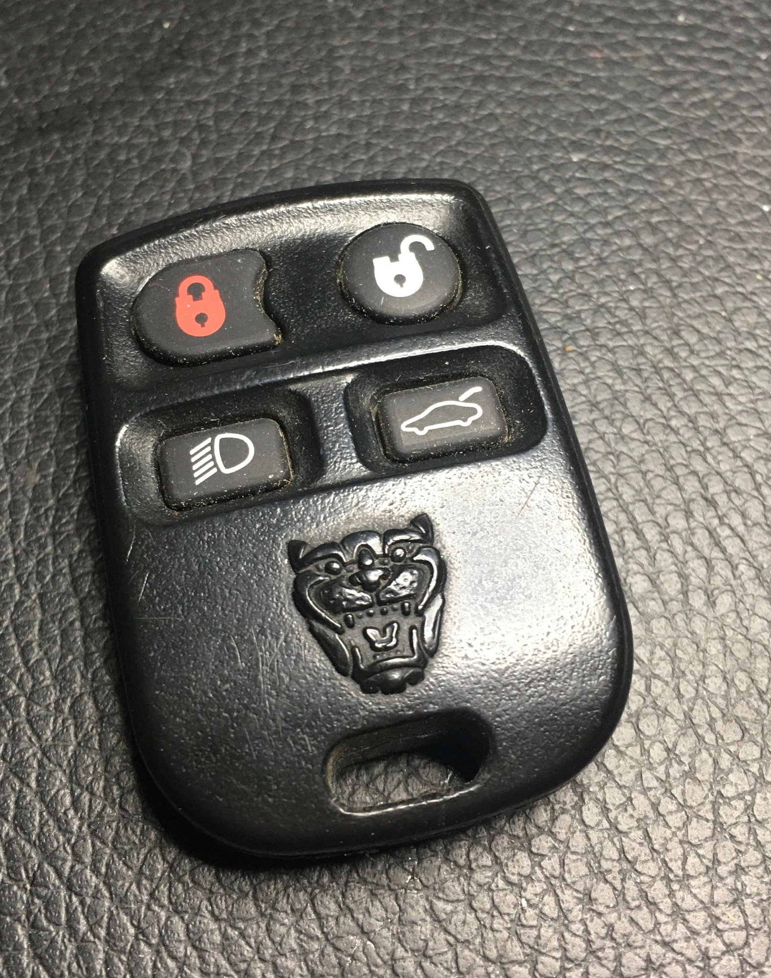

Hi Guys.
Hopefully some who are looking for replacement XK8 key fobs, which are getting hard to get hold of, and increasing in price, this may prove useful. One of my fobs packed up, dead, can't be repaired, so looked for another in all the usual places.
I am looking for an LJE 2600-BC, as my Jag is a late 2005. Eventually found one on Eurojag for £77, so bit the bullet and bought it.
Arrived today, but although advertised as BC, it was in fact BB, now, as I am one of those people whose glass is always half empty, I feared the worst, however went to the car, went through the programming cycle and........"Hey Presto" it works, if only I had known that, as on ebay the BB fobs were cheaper, but I didn't think they would work.
Perhaps even the BA fobs might work?, possibly, but FOR DEFINITE both the BB and BC work equally as well as each other.
So hope this might help somebody out there.
