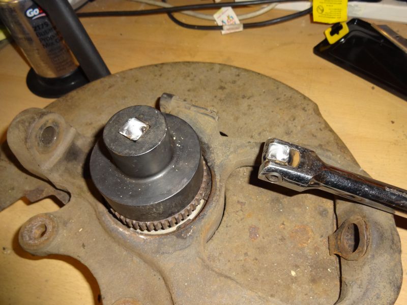

I wrote to Laser today about their hub nut tool suggesting it was not fit for purpose as it only has a socket for a 1/2 inch bar.
Laser Tools | 5537 | ABS Rotor Nut Socket - Jaguar
They said that they have now (some time in 2013) changed their design to have a 3/4 inch hole.
So beware when buying this item to ensure you get one of the newer models.
Their web site still shows the old model as does the data sheet and I suspect there are still a lot of them out in the distribution network.
I asked them for a replacement but they did not respond.

I'm with RD on this one, the 1/2" drive is not good enough, I snapped my reducer on it and getting an impact gun on it is fine if you happen to have a 3/4 one laying around which I don't
I actually welded my reducer to the tool making it a 3/4 drive.... No probs since

I guess you have been lucky, I think Laser must have had multiple complaints to change their design.
