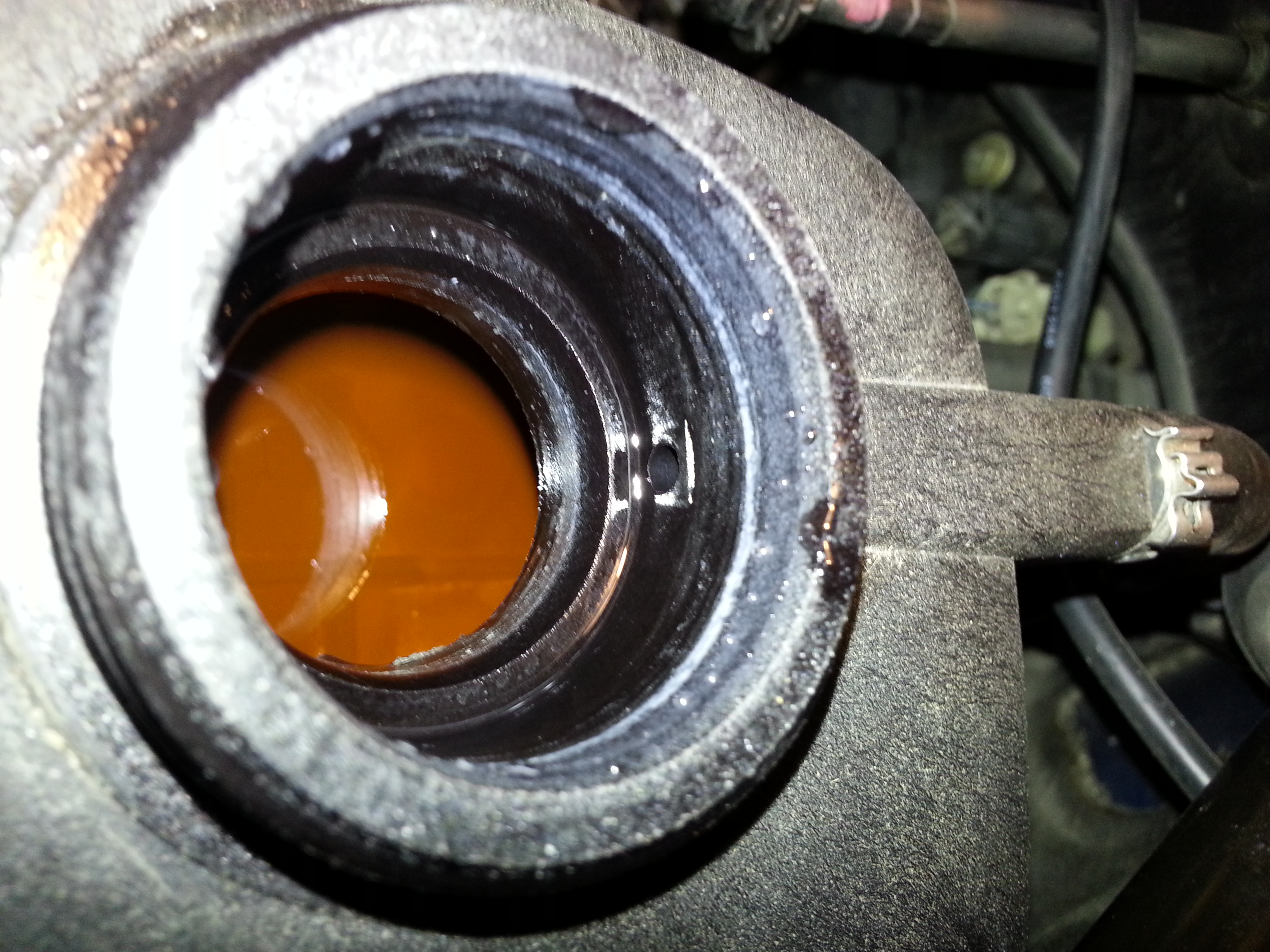

As far as I can see your bleed line is correct being a -98.
The bleed port from the reservoir to the recovery tank is in the aft part of the filler neck. (See picture)
The reservoir cap is somewhat complicated, and I don't have the full understanding how it works. But I think the bottom part opens at a certain pressure/temperature letting coolant flow through the bleed port to the recovery tank.
When engine cools, coolant is drawn back from the recovery tank.

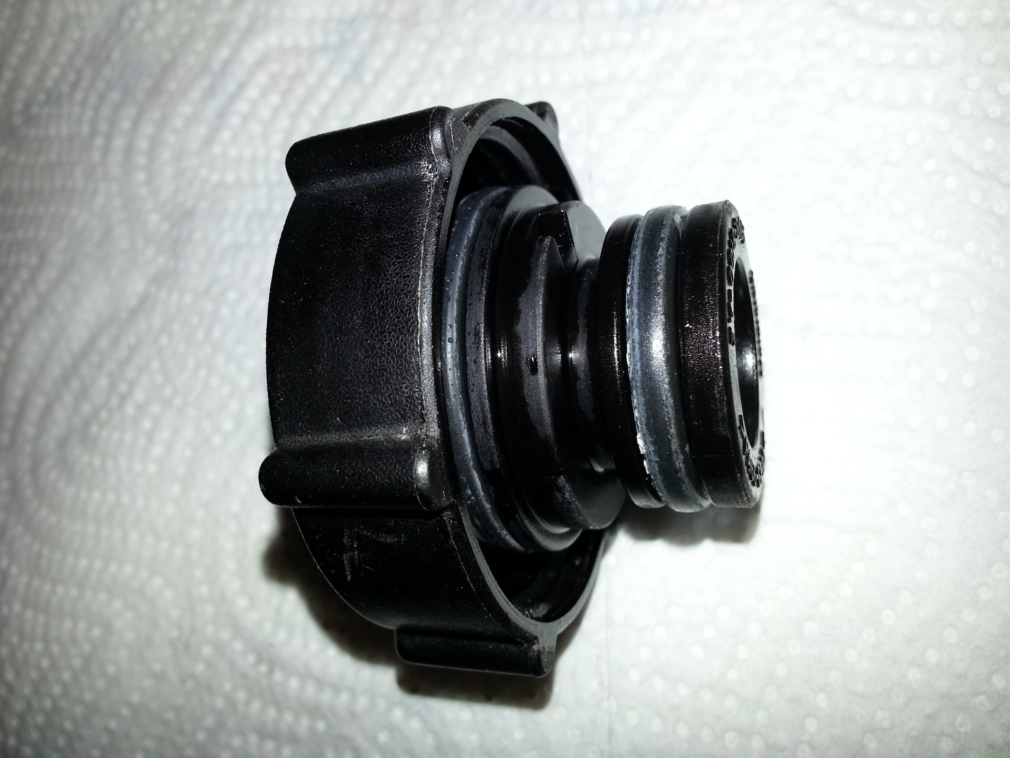

There is a metal thing in the top of the cap. (See pic) I don't know what it does.
My best bet now is a problem with the filler cap. I would get a new original cap.
