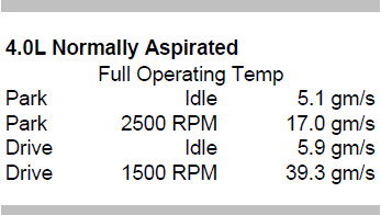

Glendoramike:
I noticed that part of your post disappeared and it stumped me for a while until I figured you'd pulled it
I've been through everything you mentioned (except the flashlight bit on my - new - air filter; that's a new one for me) as I systematically sort my way through the JTIS.
I actually had a new (rebuilt) MAFS in hand at the very start and took a bunch of readings with it vs. the old one. Some people report their MAFS being "stuck" and giving only one or two readings or no readings at all. Not my case, in fact the old one tracked pretty well to standard and to the new one also. So I moved on.
After not finding anything else obviously wrong I'm circling back to - as you point out - the simple stuff, the MAFS. I should have run it for a day or so with the new MAFS. Live and learn.

Is it fixed? The ECM needs a good idle and a good drive to re-learn or learn about changes. Especially parts changes.

here's the data I promised...
Ignition turned to ON, w/o a start
At idle, in PARK
At 2500 RPM, in Park
Old Mar 30, 2011 | 08:58 AM
