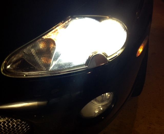

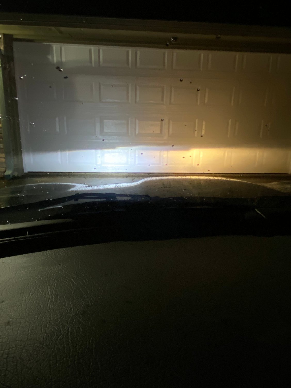

The original halogen headlights couldn’t hardly show me 25 feet in front of the bumper. Got some Hikari H-1 LED. Wow! Here are a couple pics with only one replaced.

a big improvement - have had mine in a few months and very pleased with them!

ABCamp,
In other words, you have replaced your Stock Halogen Low Beams with a Hikari LED Kit....rather than using a HID Kit like most XK8-XKR's came with.. Now, you need to replace your Halogen High Beams with another LED Kit and you will have the Night under control. For an example, I have attached a photo of my Lights on Bright! They are (Low Beam) HID and (Hight Beam) LED...You want to make sure the Kit you buy has a short stalk, because your High Beam Headlight has a Reflector background and the Light source on the stalk must be as close to the Reflector's base as possible. If not, the Light will scatter all over the place! This will make your High Beams ineffective....as for as Lighting the Road at a distance...By having the short Stalk LED, it places the Light source back toward the rear of the Light, at about the same place as the Halogen Bulb emits it's Light and helps the Reflector direct the Light forward...Honestly, it makes a lot of difference....
