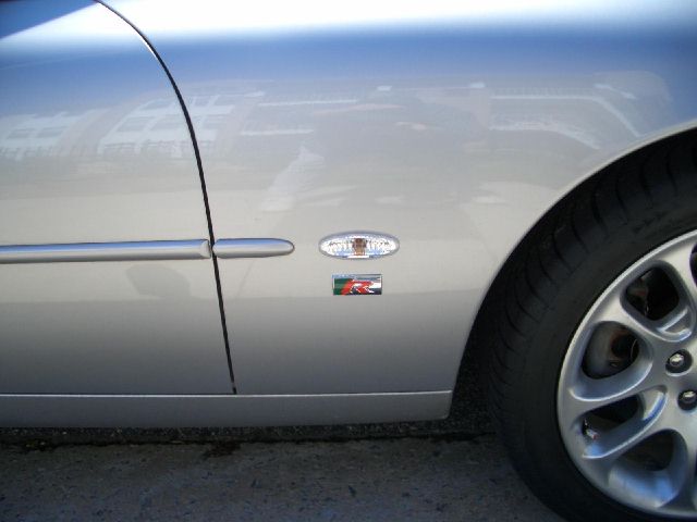

I went a different route and replaced mine with ones that I like better. I am going darker, having also replaced my side lights with darkened LED's, and these tie in nicely. I know, they are not for everyone, but then again, I'm dialing it in to suit my own tastes.

Yea, Jag didn't ship the cars with the side repeaters until 03. They all are pre-punched on both sides to accept the repeater lights, but the wiring is only complete on the left side. The right side needs a harness that goes from a plug under the fuse/relay compartment into the wheel well. A very expensive harness. I up-graded to the repeaters in clear with amber lamps and it goes well with the platinum silver paint.
