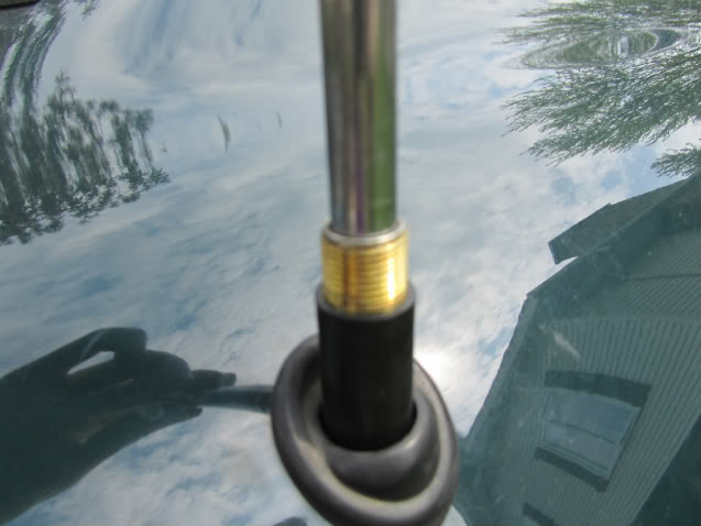

The gold part is the thread where the chrome nut was screwed.

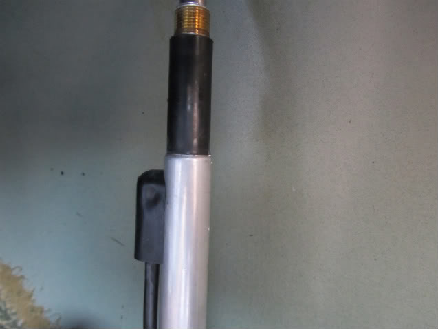

As a reference, you can see the gold thread. You also see the black thing preventing me from pulling the mast up any further.

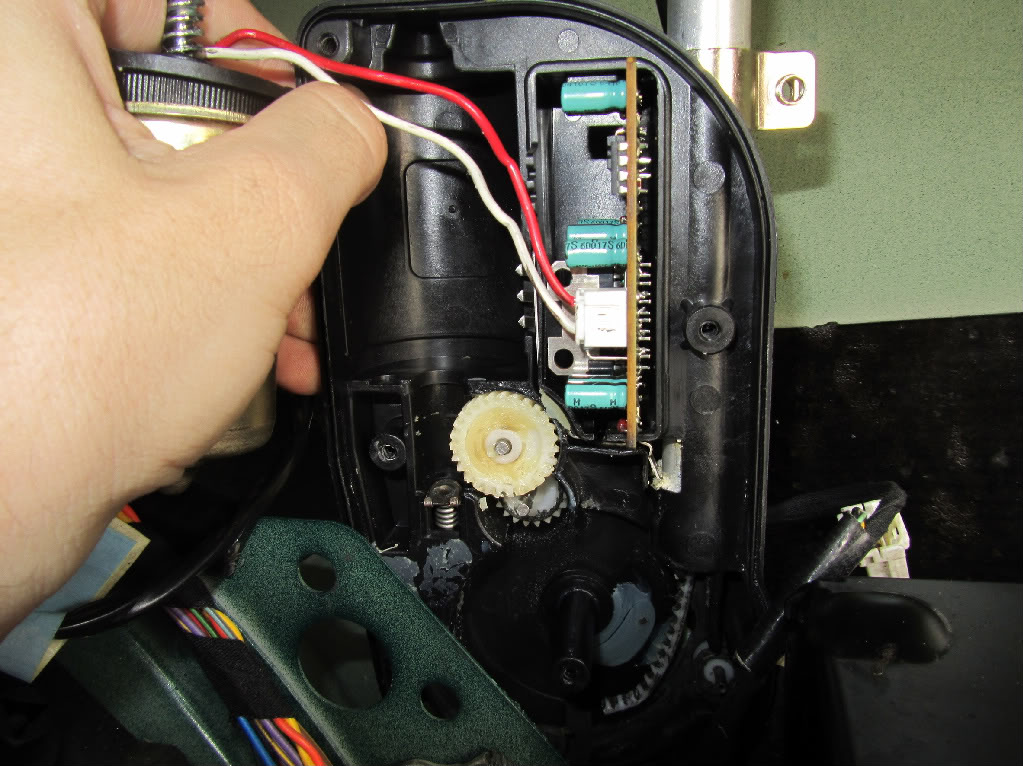

And finally, you see the mess I made of the motor assembly.

It looks to me like you should be able to take some snips and cut the little cog thingy on the bottom right of the photo. That would release the mast and you could just pull it out. But then you're stuck without a working antenna. You'd have to remove the motor assembly to get out the remaining piece of the cog belt, then you could install the new one.
