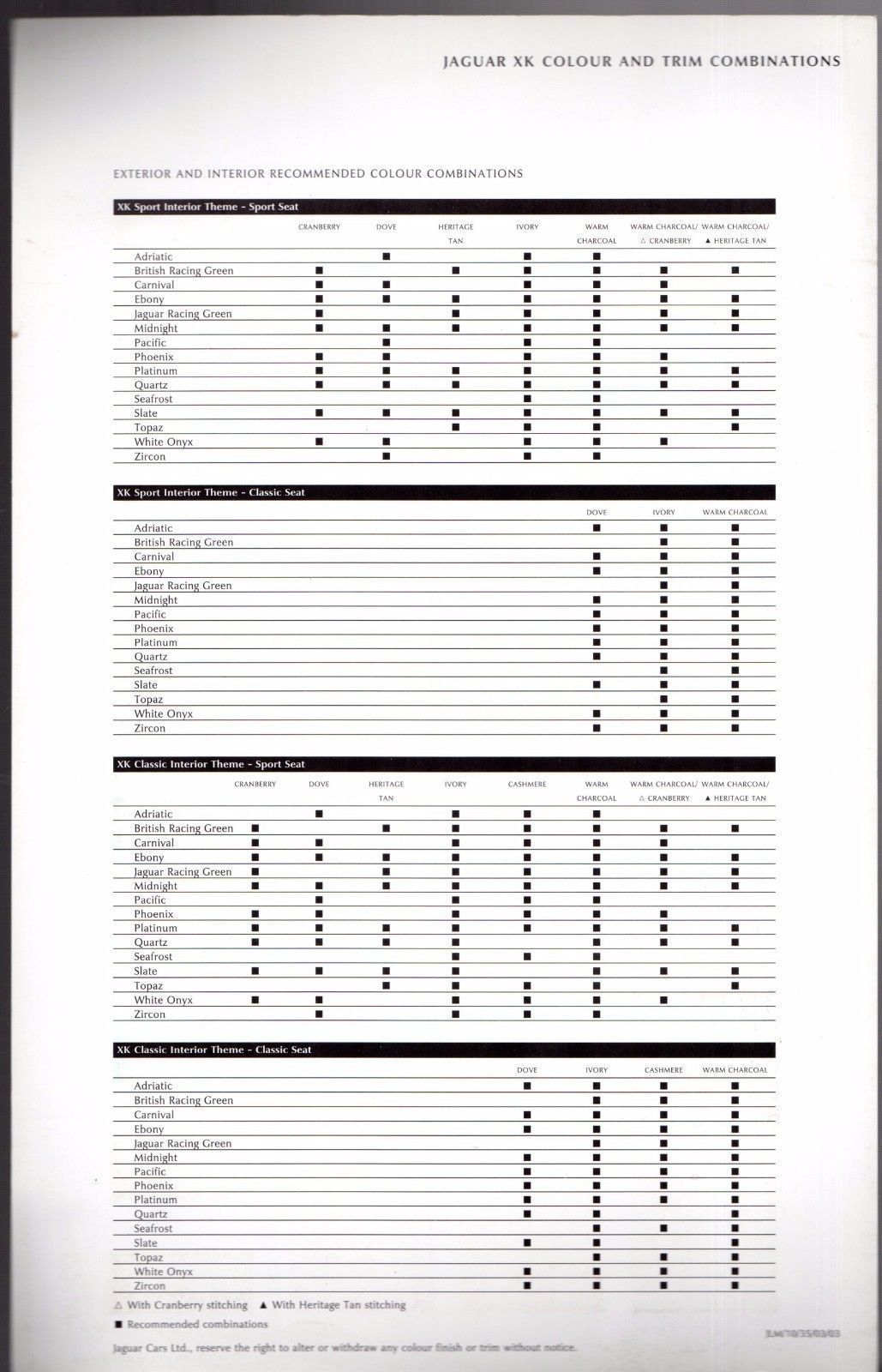

metric, welcome to the forum. Here are the colour options that were available in 2003.
