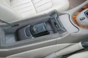

I thought by 2005 that Bluetooth had finally replaced handsets in Jaguar but this could be market dependent and therefore different in the US. Certainly the only phone option on my 2005 Final Series XK8 4.2-S was Bluetooth.
The last analogue phone fitted by Jaguar was the Motorola GSM.
This superseded the StarTAC in around 2001
A very neat installation in its day. I had one in my 2000 XJ8.

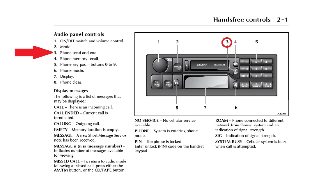

Thanks, Graham. How would I be able to determine if my model has Bluetooth?
Old Apr 22, 2014 | 06:05 PM
Likes: 17,009
Other than dismantling the Centre Console and removing the Rear Seat to check for the hardware, the easiest way is to try to pair a phone.
1. select Phone mode
2. enter discovery code ##3#*#
3. press Send
If you have Bluetooth fitted, Discover Me will display and the system will start searching for a phone.

Silly question, but I'm not seeing the "send" button.
Phone SEND/END button is item 3:

I tried this and it appears my car doesn't have BlueTooth
