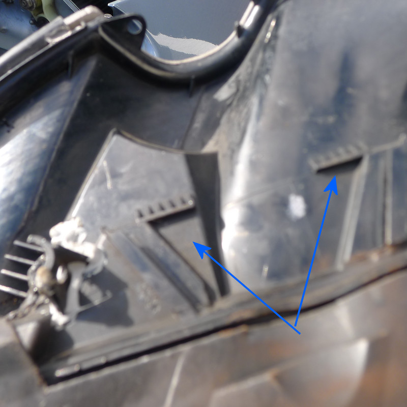

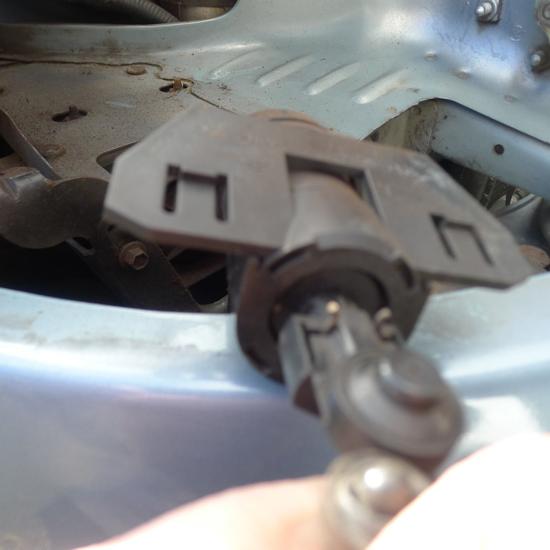

From: Malvern, England
I dont think its loose. Yep I know it stands out from the car and wobbles, sounds like me Basically what was mentioned above.
The flat bit on the washer slides into a V shaped bit on the underside of the headlamp. Its a real bar steward to get into place, even when you know what your doing.
This............
Slides into here. If it doesnt then it just flops around loose.
You might find this an interesting read................ Click Me
This............
That is interesting. So, how do you put it back in place when you are fitting the headlamp on the car?

What worked for me was getting the headlamp most of the way back in first, then raising it up just enough to slide the v back in. This was without the mirror piece in place, and with the bottom screw boss half broken off from a previous owner. I then pushed the mirror piece back into place. If I was doing it with a whole one, I'd do it mostly the same way, but with the inner wheel liner removed to access the bottom screw better.
John you could not have described it better. The headlamp 80% of the way in. Then slide the V back in. You will know its in place as you wont be able to pull it out again as the two interior clips should have locked into place. You can sometimes use the 'nose' of the washer to help push the V backwards. Its not easy!
As for the bottom screw I was lucky. Someone had tried before me and not bothered to put it back in. I left it out too!
