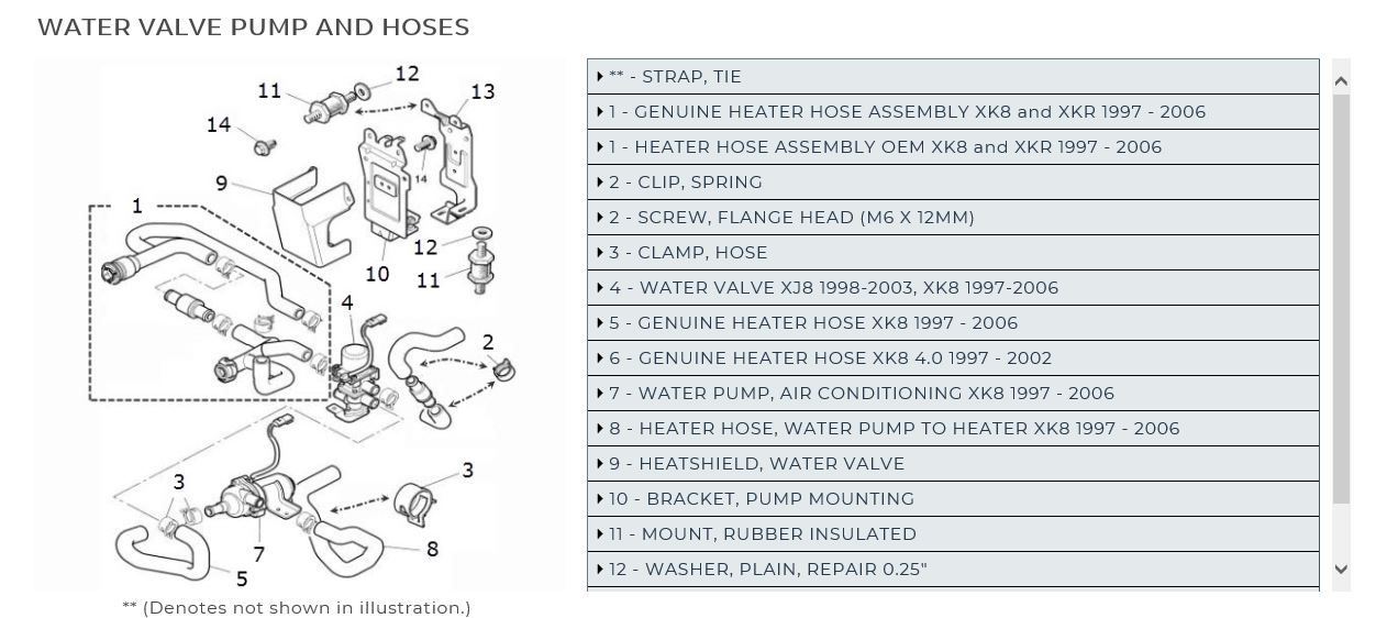

When you say you replaced the hoses, are these only the hoses at the front of the engine?
For my 99 MY XK8, I did have an undetectable coolant leak for a while, and found it while under the car. It was the infamous Octopus Hose connections leaking. Fix is DIY - able and viewing from top is very difficult as it's buried by the bulkhead. It was made easier for me as I had the car up on a friendly mechanic's car lift.
Fit up as shown below. The Octopus is Part 1 in the Figure and the big arrows point to feed and return through the "Valley" of the DOHC engine.
Good luck on your search and let us know what you find.

Default How about the hoses from the water valve to heater core
Jet Jack,
You obviously have cared for the car, but what about the hoses to between the heater core and the water valve.
Another possibility, as suggested by Fmertz above, is a leaking seam in the plastic bodied expansion reservoir.
