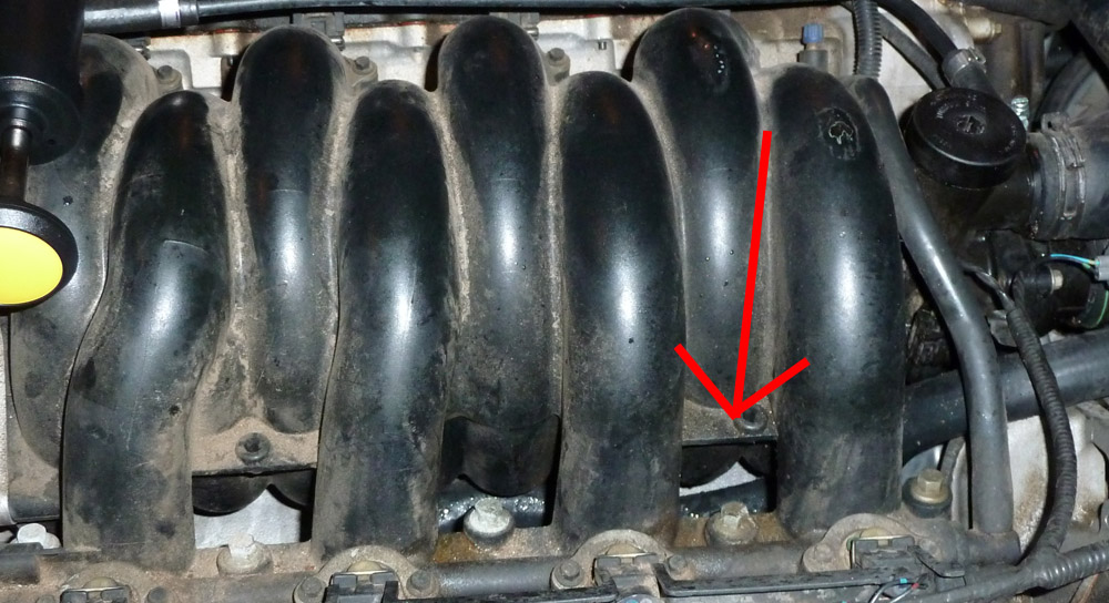

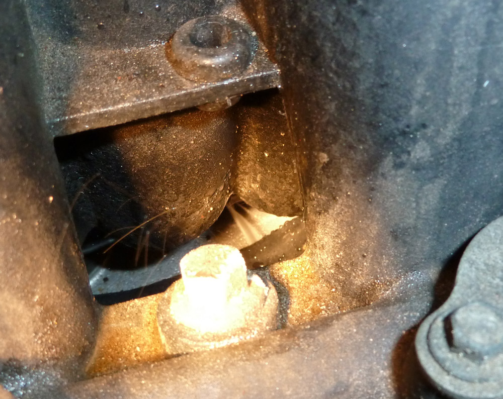

Well, it's not the thermostat housing.
I topped off the system with water so I could see the leak.....this explain why the noise was so hard to pin-point since it's coming from a hose under the intake manifold.
In the first photo, the hose at the bottom of the picture is fine and I think I replaced it since the clamps on both ends looks new. It's the hose buried under the intake spraying down.

From your description, I believe you are talking the heater return hose, 1 of the 2 heater hoses that run under the intake manifold on your XK8.
The 1st hose, the heater feed hose (the one that you already replaced), connects to the coolant outlet pipe above the front of the engine & runs under the intake manifold where it then connects to the heater pipe at the rear of the engine. The 2nd hose, the heater return hose, also runs under the intake manifold. It runs from the back of the water pump housing (directly below the thermostat tower) to a connector at the rear of the engine.
You will have to remove the intake manifold to replace the heater return hose. I did this job replacing both hoses at once on my 97 last year & it was not too bad.
