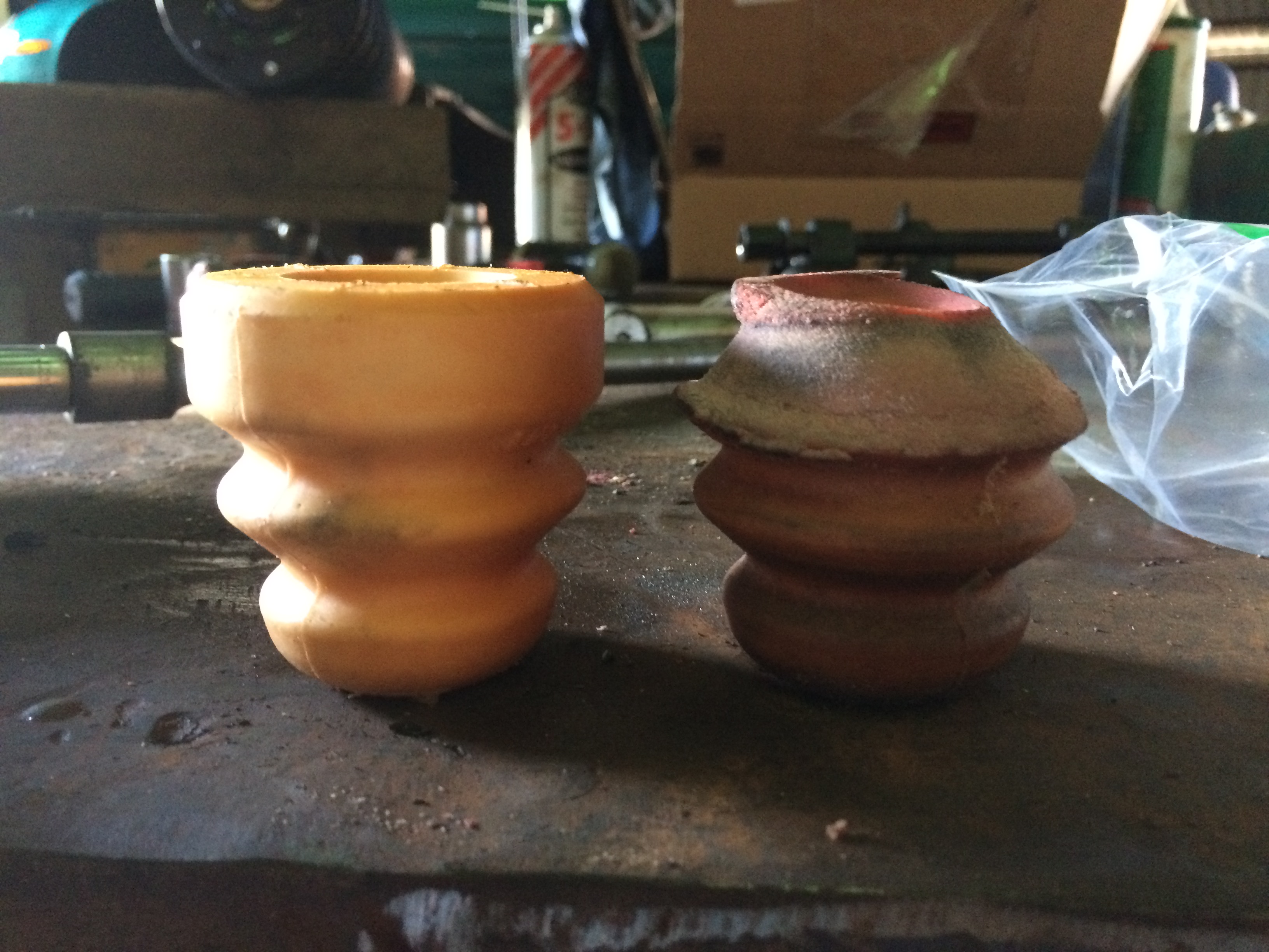

Default Front Shock Knock
Hi Oyster,
I replaced my LH front lower shock bush, top mount assy and bump stop last weekend on my 98 XK8 coupe. Interestingly, I was in the opposite climate to your good self, in North Queensland, Auzz @ 36C and 90% humidity, so I won't complain......!!
I had a knocking sound from the front the LH front side when the leg extended over a shallow gully and thought it was my top mount. It turned out to be the bump stop, as per the photo. Fortunately I had ordered all three parts before I started the job, so although not stuffed, I replaced the top mount too while in there. I've only recently purchased the car, but almost certain it was the original mount.
Interestingly though, I jacked up the RH side with the normal car jack and notice that you can inspect the bump stop quite easily to check for condition, which on my showed this one too is of the same condition i.e. U/S and will be replaced shortly, along with lower bush and top mount. This should put them all to bed for many years, which is my general philosophy....do it once and do it right. The main point of my post though is don't discount the BUMP stops too quickly and they probably the easiest things to check.
The post by RaceDiagnosticswas helpful and will assist me when replacing RH side lower bush, so thanks

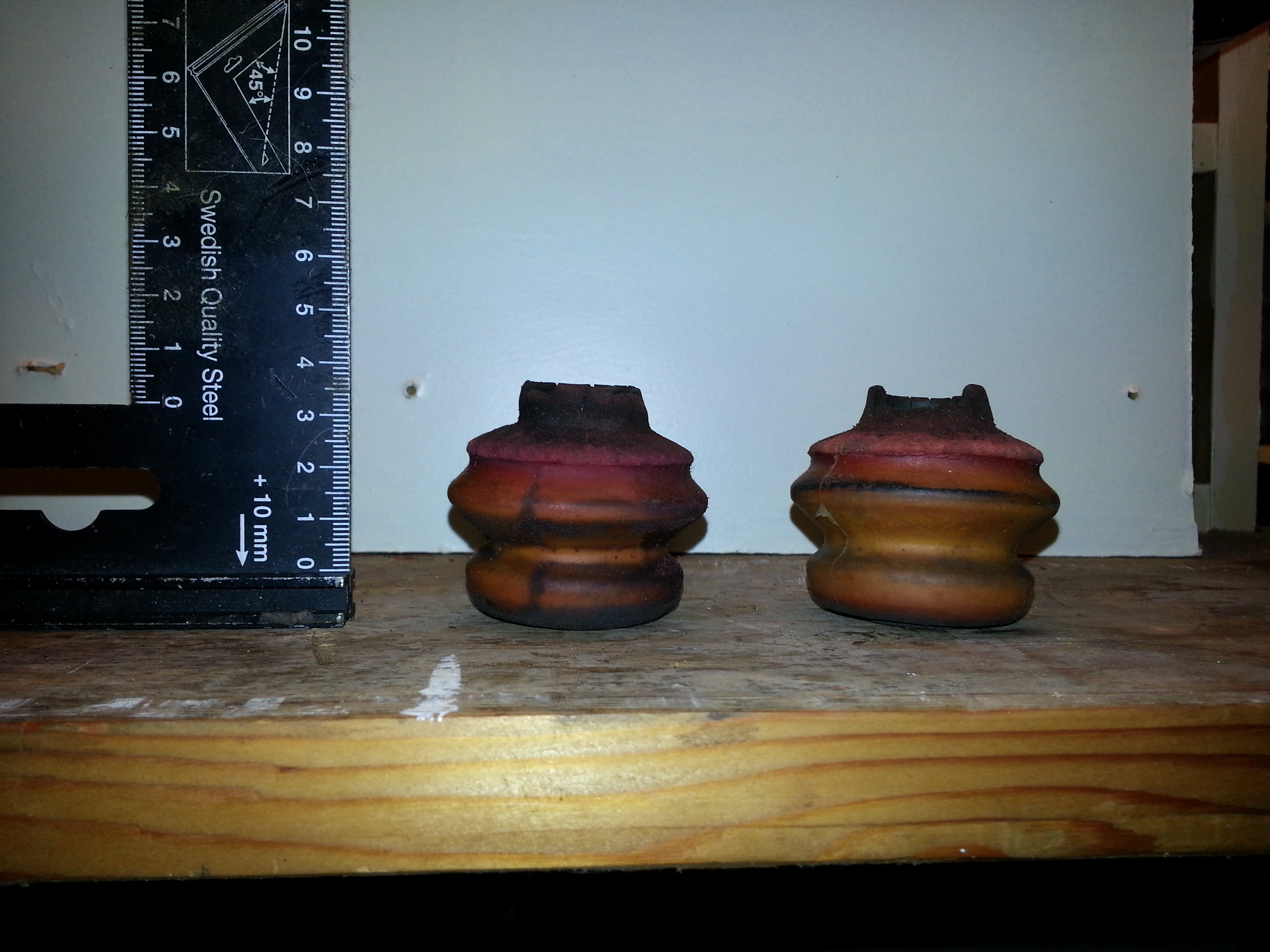

Interesting you should mention the bump stops. Mine were completely worn out as yours.
After replacing lower shock bushes, upper spring pans and bump stops, I gained about 1,5 to 2,0 cm in ride height.
Also replaced anti-roll bar bushes and links. Feels more tight all together.
Old bump stops:
